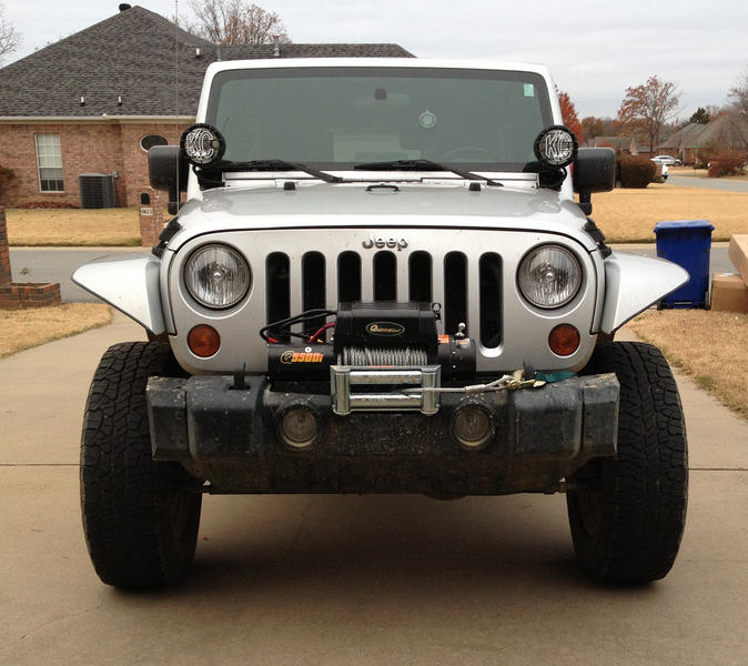

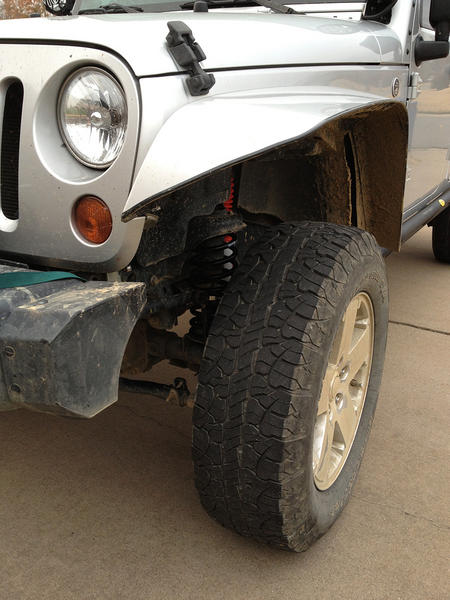

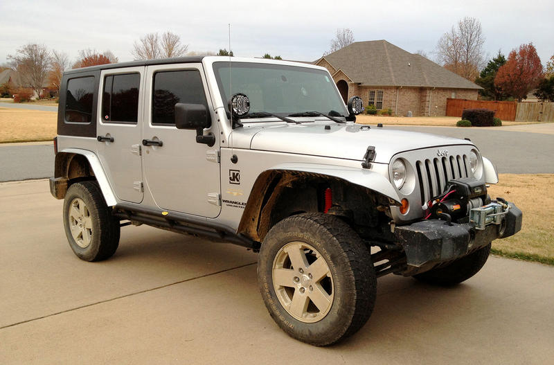

Yep. I love mine! They turned out great. No cracking or other issues. The hardest part is getting the nerve to make the first cut :-)

No flapping on mine. You leave the structural support under the fender in tact on the front to keep it rigid. Just to be sure I used a little JB Weld to glue the two pieces together to make sure it doesn't flap around on the interstate but I don't think it's necessary.
Just start out at the widest part of the fender so if you sneeze or something while cutting and don't cut a straight line you have room for a second cut. My philosophy was if I screw it up I can just buy Bushwacker flares.
Go for it!!!

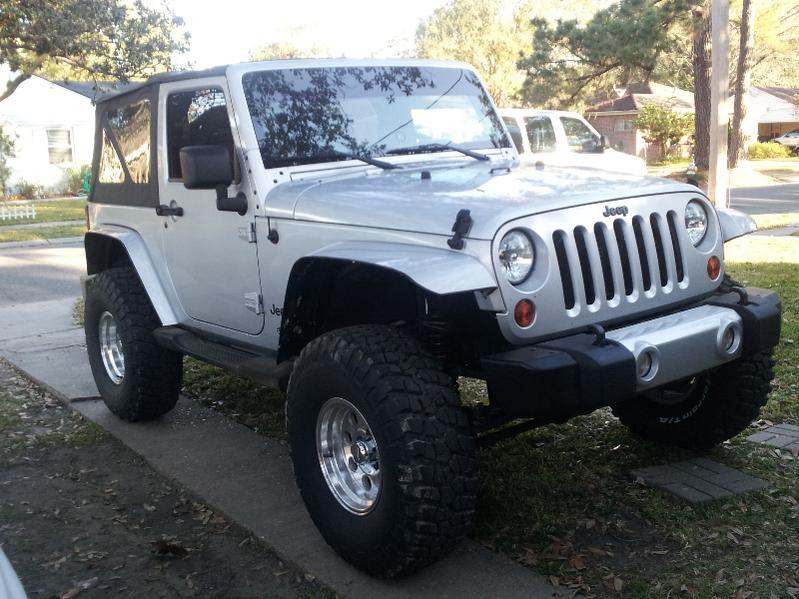

No problems. Used door molding also..
