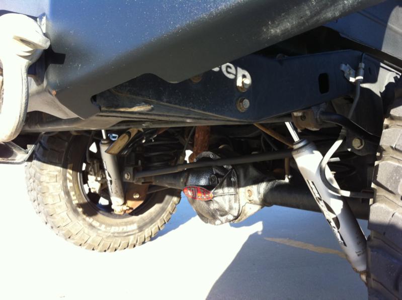

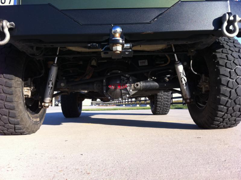

I made a custom dynomax system. Did a lot of research and found that all the cat back systems are the stock OD 2.75". With that said, ordered the same muffler that is used with the dynomax rock crawler system, removed the factory muffler, made some cuts, welded in the muffler and a tip i picked up from the local parts store. Saved a lot of cash and man this thing works amazing, sounds amazing and the clearance Gained is phenomenal.
I have a 2 door but same deal. Also, pick up a rattle can of high temp black paint and paint the rusty factory exhaust tubing. Looks great afterwards!
Here's some pics:

Thanks! Took all of 4 hours said and done. Now I started from scratch as well and only saw one other person who did the same, but they used clamps and had a little different set up. Said and done cost about $125. I've also crawled with it since and not a scratch on the muffler(I do have a evap skid that protects it though) and the clearance in the rear is great. My factory muffler was crushed like a can from sitting on rocks. Good luck!

Solid work, looks really good!
