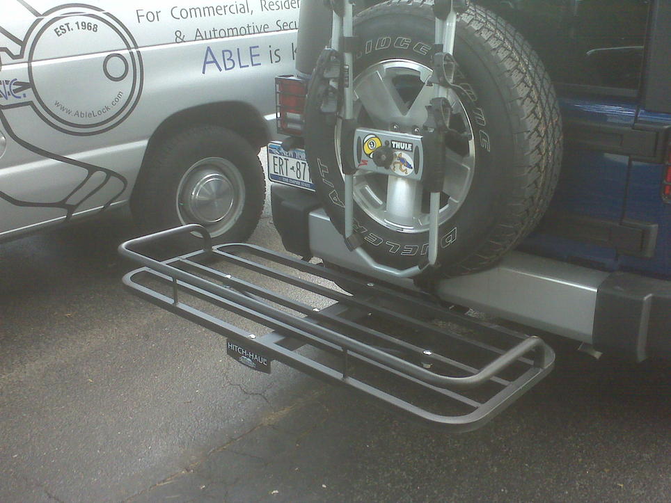

This is the hitch-haul, its actually the one for atv's and its rated for 300lbs.
got it from cabellas, $60.00 shipped. Would definitely fit a larger tire.

SethC84, that's about the nicest one I've seen yet...I got one from CdnTire...a sportrack model, and didn't like it one bit, at least that one looks fairly decent
Old Oct 11, 2009 | 04:43 PM
Sethc84's Avatar
Posts: 203
From: Long Island, NY
I looked for a while before I found one that I liked and the good price didn't hurt either. What I like is the bend in the tube to bring it up off the ground. What I don't like is the play. It bounces around a little (not the tightest fit in the hitch).
If they have a Tractor Supply Co store (or Google it to find one online) around you anywhere, go and pick up an anti-rattle hitch pin. It'll tighten the carrier up nicely. Still wiggles a little bit with a load, but 10x better than with a regular pin. The one I got is lockable also. I think it was around $20 or so, but worth it IMO.
