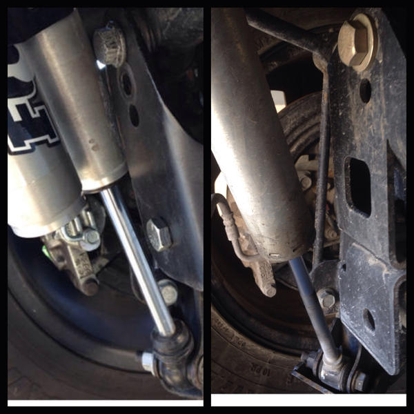

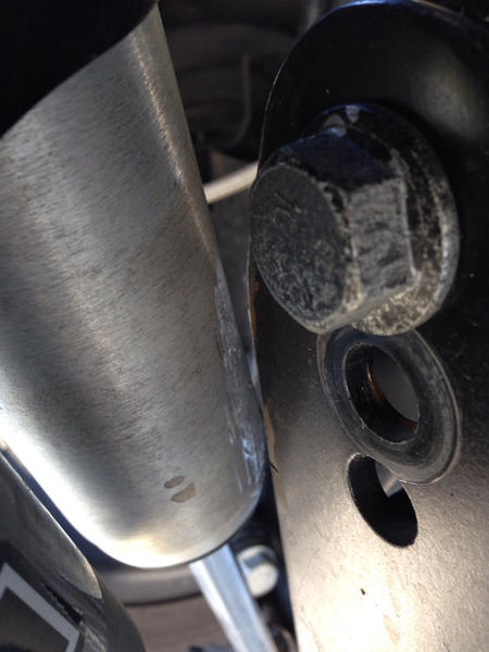

My drivers side rear shock is coming into contact with the Teraflex trackbar relocation bracket. Damage seems to only happen offroad. Has anyone else experienced this issue? I'll probably try to relocate the rear shock mount, but this looks like a minor design flaw when using this relocation bracket & wanted some more insight from others.
-Mike

Btw, in the pic I moved the reservoir mount UP a little since it was rubbing against the trackbar bolt as well.

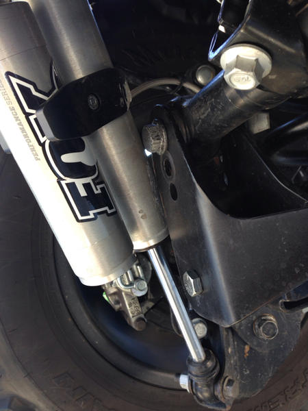

I did a comparo of yours and my AEV bracket to see a difference. I was wondering if your bracket is rotated back too much? Dunno

TURTLECON's Avatar
Posts: 5,192
From: REDONDO BEACH, CA
Originally Posted by BuckLisa
I did a comparo of yours and my AEV bracket to see a difference. I was wondering if your bracket is rotated back too much? Dunno <img src="https://www.jk-forum.com/forums/attachment.php?attachmentid=521812"/>
It looks like your relo bracket sits directly above the stock one. The teraflex bracket mounts against (and above) the stock one... obviously more rearward.
