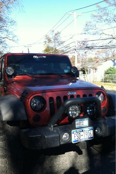

I have the draw tight 2in front hitch. I like it but I'm probable gonna be getting rid of it because it won't work with my new bumper. Pm me if your interested in buying it. Thanks
