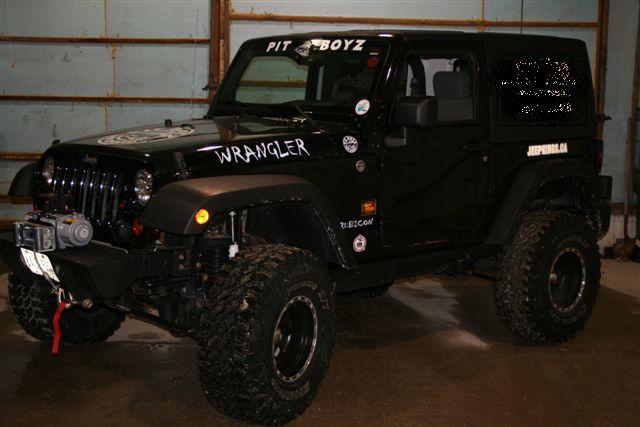

i am running eagle alloys 185 series ( i think) 15x10 -45 mm offset ( dont know what that is in imperial... no rubbing
185's are around $105 USD...iirc. i got mine for $550 CAD with the tires broken down off my old rims and installed on the new 185's... good deal i thought
the soft 8's can fit... just have to grind the back of the "dimple die" "D" holes or run 3/4" spacers
