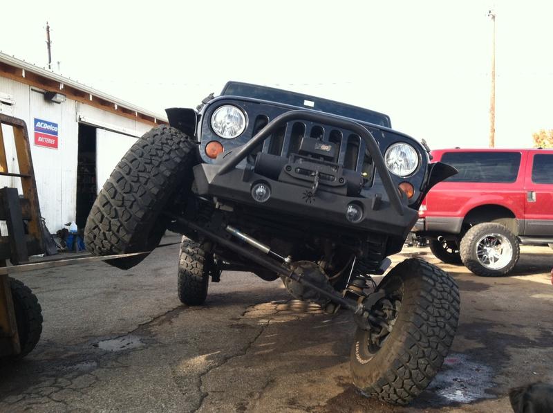

I had 5100's and was interested too in changing out for the Bilstein 5160's. Dave at Northridge 4x4 mentioned the only difference between 5160/5100, the 5160 will offer a more consistent feel because of the cooler dampening from the reservoir, otherwise feeling much like the 5100's. They talked me into Fox 2.0 Remote res shocks as they are better performers offroad where the Bilsteins tend to be more suitable for street. Just what I was told from Northridge. I really liked my 5100's, but couldn't be happier with how awesome my Fox 2.0 remote res shocks turned out to be, love em.

Ran these shocks on my previous suspension setup, they're nice and smooth but even better if you have a heavier 4-door with hardtop, and full bumper with tire carrier. These shocks have like 11.75 of travel up front and 11" in rears with the EVO rockstar skids. Wished they came with built in adjusters like the Kings.
