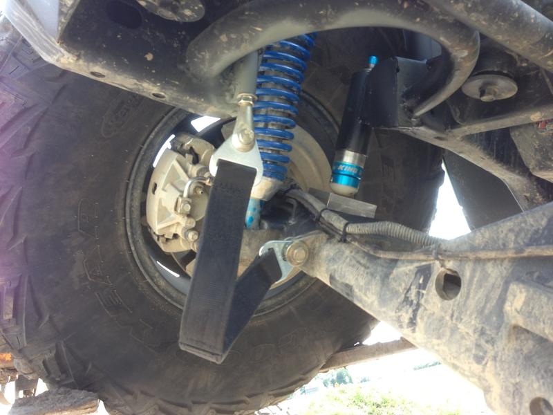

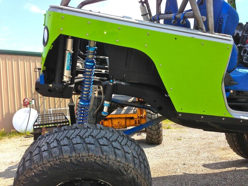

I have 5 of them on my rig.
ID:	538930Click image for larger version
