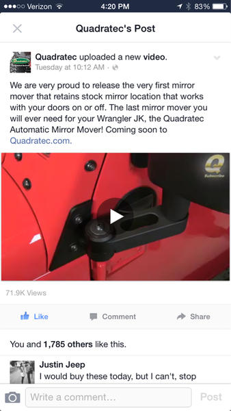

I like quatratec's new automatic mirror movers. But they are not cheap. No useless right mirror.
http://www.quadratec.com/showcases/n...ror-movers.php

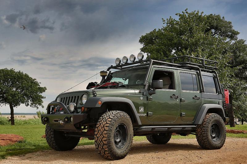

Back on topic, when the JKs first came out Mopar offered a driver's side mirror bracket that came with a TJ mirror. I've used it. It doesn't solve the passenger side, however ...
TJ mirror mounted ...
And I just leave the bracket on rather than risk spinning one of the nutserts in the windshield frame ...

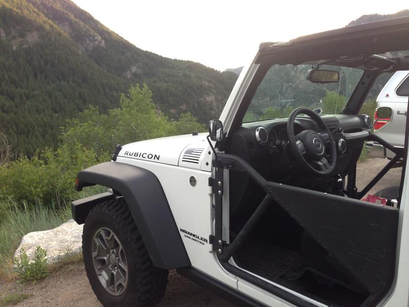

If you are looking for what to do for mirrors with doors off, I recommend getting these: Tapered Long Stem Mirror, Left Side-91910-03B | Handlebar Mounted Mirrors | Official Harley-Davidson Online Store
They work terrific and mount right into the door hinge bracket. It looks good, low profile, and you don't have to worry about taking the mirrors off the doors. They work terrific for the passenger side too. No issues with that side. Unfortunately I don't have a picture of it mounted like that, but it does work great.
Then, if you end up getting tube doors, you can mount the mirrors right into those. And again, you won't ever have to remove the door mirrors.
