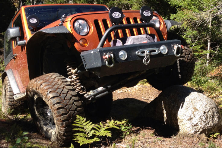

Sorry mine not the hybrid but it's RC.

I have one. I'm very happy with it. The main piece is 3/16" steel and the end caps are not much thinner. Its all held together with grade 8 hardware. Very solid and sturdy. I would not be afraid to bang it off a rock anymore than my ACE rails.

I have one and it works great for me. Its essentially A recessed winch mount Plate that goes between the frame rails, and two frame rail cover plates to jazz it up. That being said for the price and what I'll use it for, i love mine...nice and light (excluding the winch of course) inexpensive, and easy to bolt on. If i had a complaint it would be the bolts they supplied are painted torque style bolts that have locking nuts. It was easy to slip a little while bolting them down inturn scuffing the paint on the bolts and now they show a little rust after only a few months, but its a minor complaint. Replacing them with stainless fasteners would solve that...all in all for the price its a great, inexpensive, clean way to mount a winch if that's your main objective.

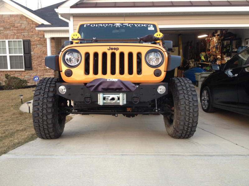

It works great I love it.

cool, thanks for the pics guys. i was going to get it W/O fog lights but now im thinking i may go with the lights.
