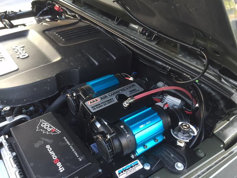

I have a 12v (single battery) ARB twin compressor and impressed with how fast the twin fills up my tires. Clean, out of site and efficient. I got the MORE engine bay mount which works great. I haven't used mine for flat repair, but I have seen the twin be strong enough to reseat a tire bead onto a rim on the trail.
It also helps to get some deflaters as well. I just went with ARB's and think it works well, but I don't know if there are easier/quicker/settable psi units out there that would be better.

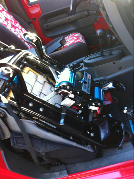

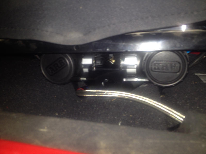

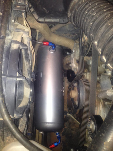

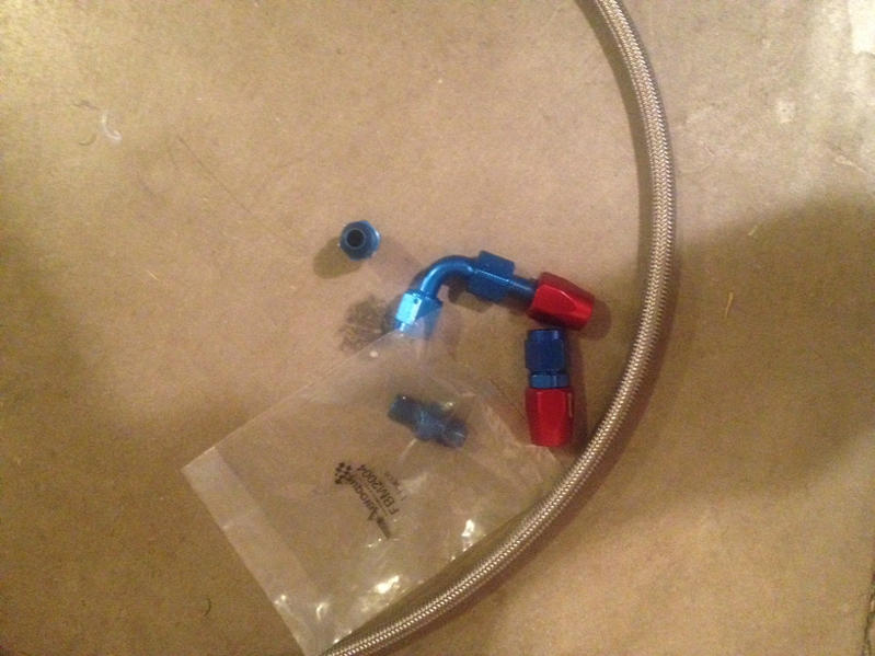

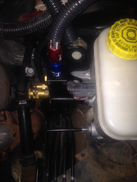

The ARB Twin is great I have Carolina Metal Masters (CMM) underseat mount for my ARB twin.
The install of the under seat mount is a bit more onerous, as you have to remove the battery and TPM to run the hose and wire through the firewall. The benefit is that it is out of hot and dirty location.

Keep in mind, unless it has changed, the CMM mount only works for JKUs because the passenger side seat does not flip up. This was as of the last time I checked back in December. I have a 2 door and my passenger seat flips forward obviously so that people can get in the back... we were able to fabricate a similar type of mount that works with the flipping mechanism but it wasn't easy.
I too prefer mounting inside the vehicle to keep it away from dirt and water, rather than in the engine bay.

Nice looking setup. Is it noisy in the cab? I'd like to run air horns off of mine when I get it so it would probably be refilling more often
