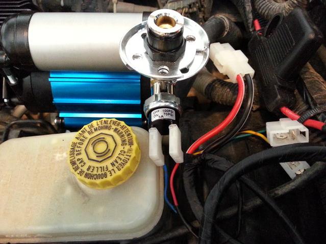

are these wires correct?

Are these wires correct on air sensor?

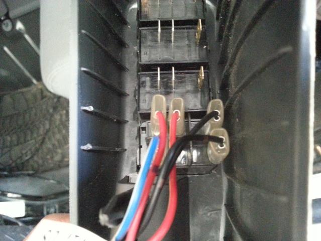

Is it required to use the dash wiring?
Name:	Dash wiring.png

yeah you need to use those wires. one is power and one is dash lights. That should complete the circuit and have everything running.

Originally Posted by DJCFHB
yeah you need to you those wires. one is power and one is dash lights. That should complete the circuit and have everything running.
sweet...where do they hook up to and where are they?
Old Mar 24, 2013 | 01:42 PM
DJCFHB's Avatar
Posts: 361
From: Hattiesburg, Ms
I dont remember which color is for what ( 12v power and dashlight) but one need to be plugged into a 12v power source and the other to dashlights. I used the cigarrette lighter on the left for the ignitioned switched 12v power source and used a volt meter to find a wire for the dash light.
Old Mar 24, 2013 | 01:46 PM
inspect-a-home's Avatar
Posts: 917
From: Texas
did you have to remove bezel or is there one just under or near the steering column?
