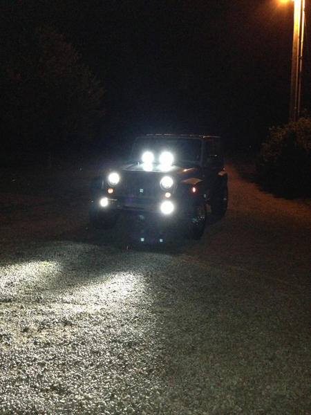

I have a metalcloak frame built bumper that has end caps that hold the oem fog light. If it will hold the oem fog light then rigid industries make a bracket that will allow the dually to be put into the oem fog light hole.
