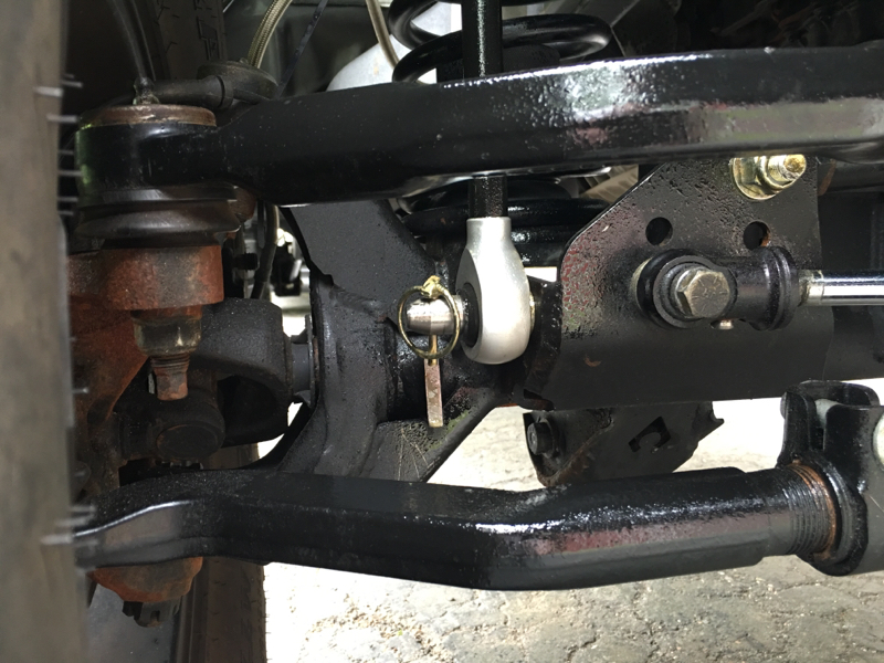

Or The SteerSmarts DL does not require drilling. Simply bolts right up.

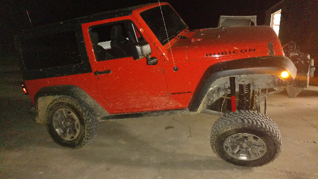

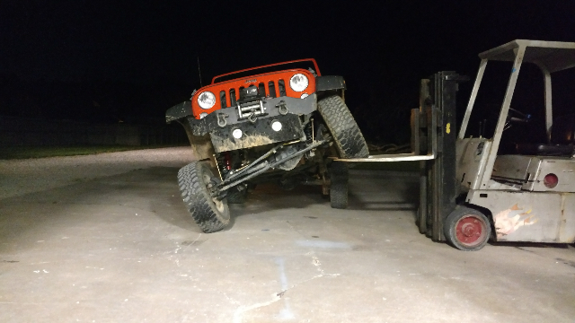

Thanks for the info. I just finished installing the lift gonna drive it tomorrow and she how it feels

Well drove it and yep, tons of bump steer. Has any one used a right-hand drive draglink with a poly tapered bushing?
