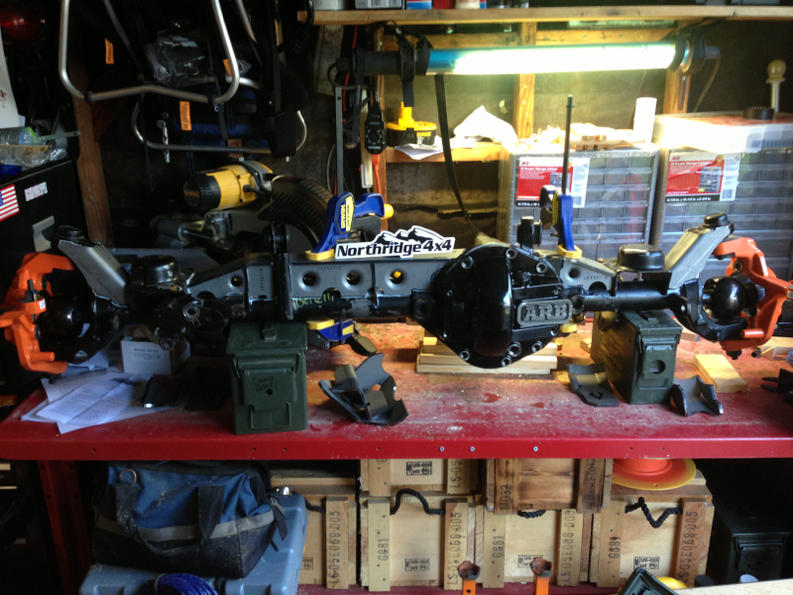

I got it for my d44. It's awesome and looks strong as hell. So yourself a favor, find someone that can weld like a champ before buying it. It requires heating the pumpkin and welding the cast. It's do able, but a PITA.
My bench fit of pieces. I'll post a done photo tomorrow.
