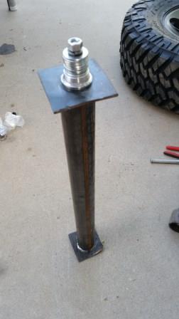

Nitro Pound In Axle Sleeves
I put the two sleeves in the freezer for 3 days thinking that I was going to pound them in with a dead blow.. think again
I removed the axle shafts which is a very simple procedure for anyone thinking about attempting this. I then cleaned the axle tubes the best I could with my shop vac and some rags. Be sure not to push anything into your carrier housing. Since my jeep only has 28k miles on it they were still fairly clean. There are some good videos on YouTube on how to clean them even better.
https://youtu.be/BOnQ8uLnTOw
. This is one I found that gave me the idea of the tool I needed to drive the sleeves in to the axle tubes after failing with the dead blow. With the dead blow I was able to drive the shorter sleeve in about 2 inches. I also tried a 2x4 and larger hammer.. still no good. That's when I went back to my local weld shop and had him build me a driver out of 2 inch pipe by 2 foot long and 4in x 4in 3/8 plate (1/4 inch would be better) with a 2 1/2 x 1/2 inch bolt welded and sticking through one plate. I then rented a bearing race driver kit from Oreillys and purchased 10x 1/2 inch by 1 1/2 in O.D. washers. See pic below. The total cost of the tool was $20 for me. I then used my 16 pound sledge and buddy to hold the driver for me while I beat in the sleeves. Once I had the driver, these sleeves went in with little effort. Most effort was from swinging the 16 pound sledge hammer.
Attachment 615573
. This is one I found that gave me the idea of the tool I needed to drive the sleeves in to the axle tubes after failing with the dead blow. With the dead blow I was able to drive the shorter sleeve in about 2 inches. I also tried a 2x4 and larger hammer.. still no good. That's when I went back to my local weld shop and had him build me a driver out of 2 inch pipe by 2 foot long and 4in x 4in 3/8 plate (1/4 inch would be better) with a 2 1/2 x 1/2 inch bolt welded and sticking through one plate. I then rented a bearing race driver kit from Oreillys and purchased 10x 1/2 inch by 1 1/2 in O.D. washers. See pic below. The total cost of the tool was $20 for me. I then used my 16 pound sledge and buddy to hold the driver for me while I beat in the sleeves. Once I had the driver, these sleeves went in with little effort. Most effort was from swinging the 16 pound sledge hammer.Attachment 615573
