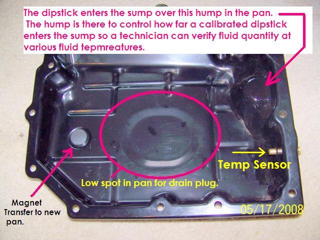

A new pan from the dealer is cheap. Drain plugs are cheap. Get both and have a shop weld it in for you. There is even a low spot in the pan where the factory SHOULD have installed one.
Name:	Drain Plug Location.jpg

nice graphic! how does the temp sensor communicate with the ECU? is it a sending unit?
I installed the temp sensor and wired it to a gauge upstairs.
That was before I knew about the AeroForce gauge, which I have now. I still use the temp gauge, though.
Got it. Thanks. I thought the temp sensor in your photo was stock or something.
How do your temp sensor readings compare with your Aeroforce readings?
The installed gauge reads about a needle width cooler than the AeroForce gauge. Could be because the factory sensor is higher in the sump, inside the valve body.
