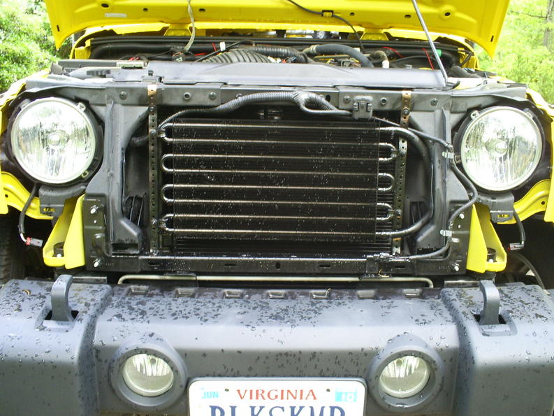

any movement at all will transfer heat buildup from a ''passive cooler''. Fans are nice, but if you are not towing a railroad car, they are not necessary....My cooler is quite large, for a vehicle up to 26,000 pounds gross vehicle weight. I've had it over a year, no issues at all...
Name:	tranny cooler 004.jpg
Which cooler do you have?
Being that it is so large; does it block air from the radiator or anything behind it?

it is a Flexalite 26,000 GVW 8 tube cooler. I ordered it from Amazon.com, $46.00 delivered. I think they are a few bucks more now.....I had to add exactly one quart of fluid to compensate for the cooler volume. The ribbed hose connectors were wrong, I bought the correct ones at Lowes for a couple of bucks. I also got the plumbing strap and the 1/2'' rubber-lined plumbing clamps there also. Look closely at my photo and you can see how I mounted mine. The engine temperature guage has never moved one iota and the A/C was not affected at all.....
