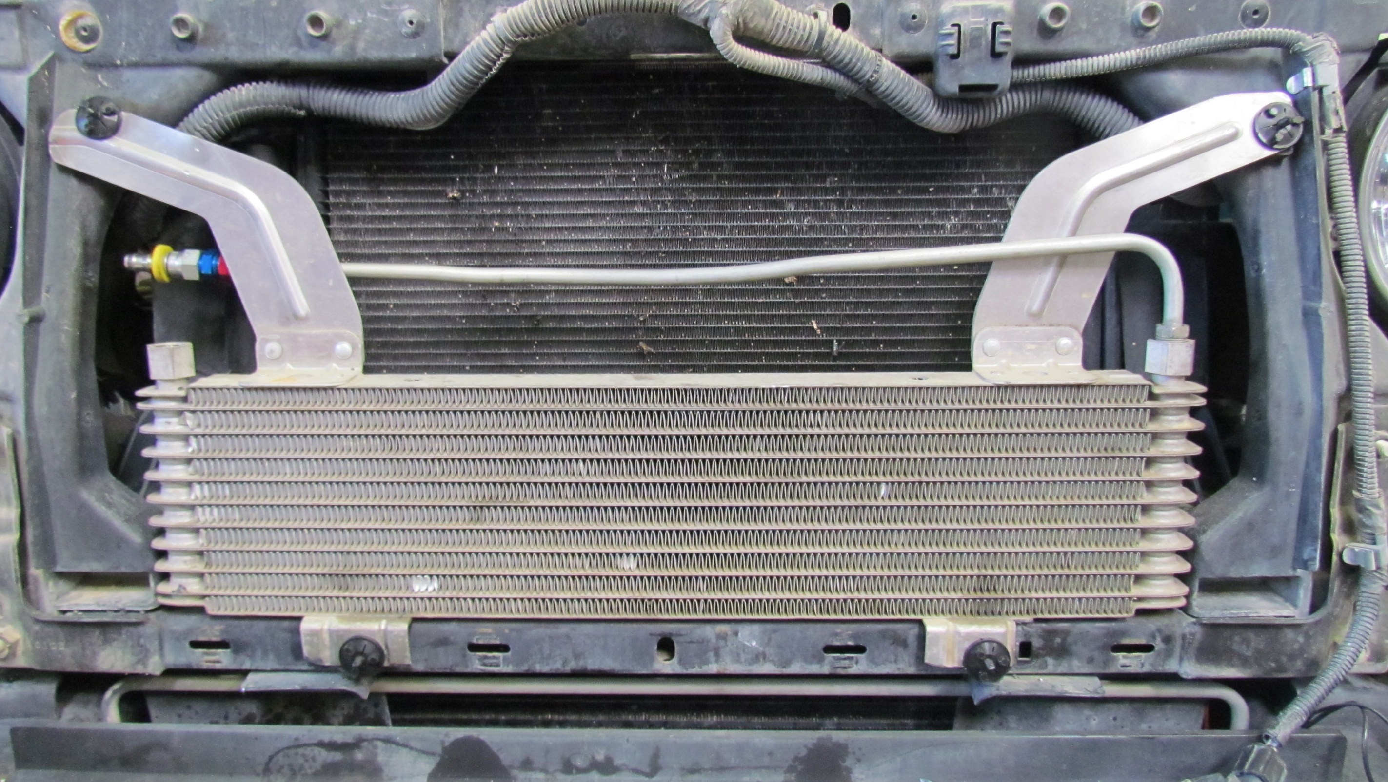

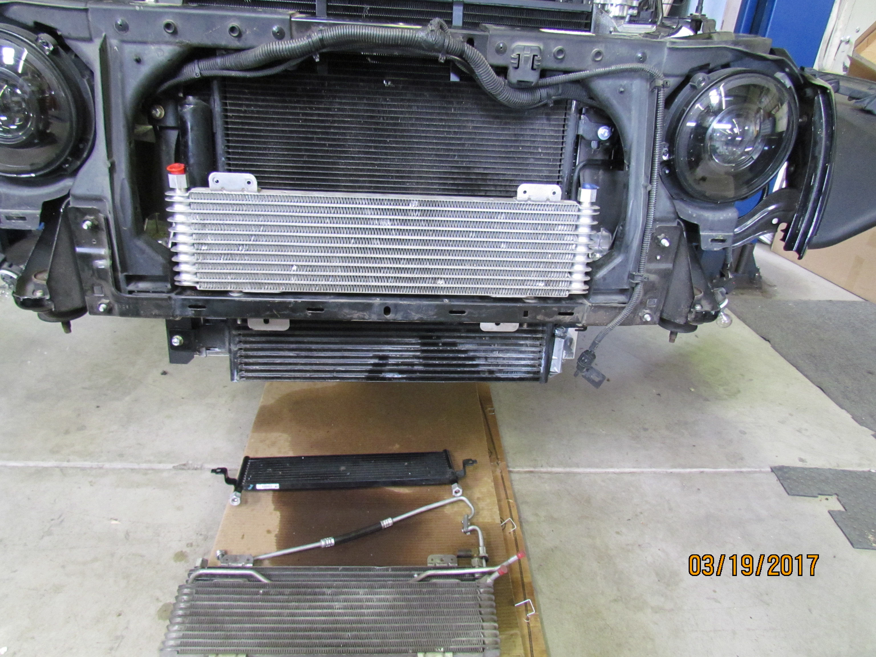

I have used used Ford coolers that I know are clean. If you want new get a Tru cool max long it has 40k btu capacity almost 2x's the big B&W
Picture's, 1st is a Tru cool for the 6l80e. Ford second
