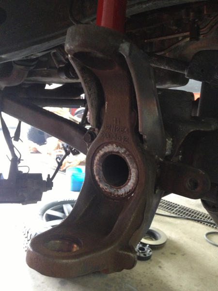

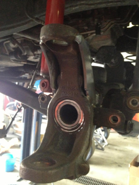

I just installed the Nitro "hammer in" sleeves. It was a quick easy job, just deep freeze them over night and clean up you inner axle before you install them. I was welding on axle c gussets at the same time so the heat helped open up the axle tube as well. Once in place, I welded the end of the Nitro sleeve to the axle tube for extra strength. RCV's will still work with this setup as well. The sleeve design will give your axle double wall thickness and provide a stiffer axle in less than 2 hours. Sure a truss will stiffen it up but you'll be spending three times the amount of time installing it.
