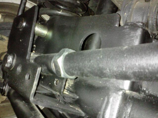

I added the JKS front track bar bracket...it really here's up the front axle...it sorta sits on there like a small truss...I am really pleased with it.

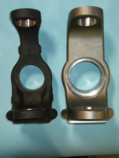

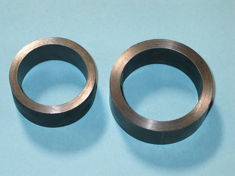

Originally Posted by sgjk
37 inch tires, wheel quite a bit, just thought if the sleeves and gussets were bout as strong as the pro rock what was the point on spending extra money
Even with the sleeves and gussets the modified stock housing is much weaker than ProRock.
The axle sleeves add roughly 35% strength. The ProRock 44 Unlimited adds 182% strength.
The added caster of the Unlimited is a big feature too as it allows you to get your steering caster angle back to stock (or better).
Check out the pics shown below. The tube comparison pic shown is the ProRock with 5/16" tube, not the 1/2" wall tube used in the Unlimited. You'll also see why the ProRock doesn't need gussets.
Name:	DT-PR44 tube comparison.jpg
ID:	213013Click image for larger version
Name:	DT-PR44 End forging comparison V1.jpg
