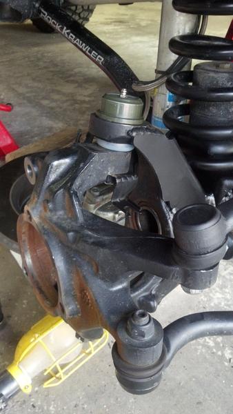

Fabricate with a longer rod (I only have this pic from another project); cut a slit on the end of the rod and insert a strip of emery cloth . With a brakeclean soaked rag tightly wrapped around and long rod (that allthread you mentioned is what I used for this + zipties), I went around the axle tube wiping/pulling out the rust/debris (not stuffing it back in, thin set up). After, stuff a clean rag down the axle tube (again, brakeclean) to keep debris out of the seal and diff and then run your "flapper" down the tube with your air grinder or whatever you use to spin it at a pretty good rate. Just cleaning the surface for a good prep, not trying to remove metal, etc.

And do your gussets and ball joints while you're there.
