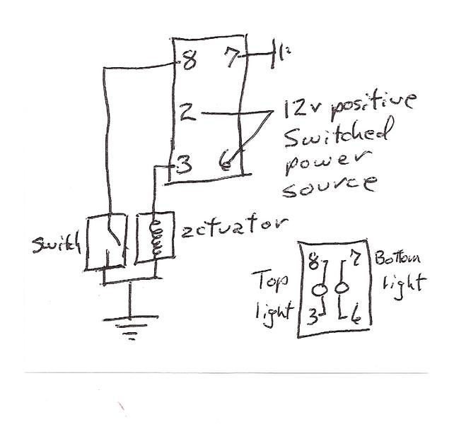

One other question about the Rubicon Tru-loc - how difficult is it to wire up? Can you get the OEM harness, or is it just a couple of wires and a switch? If I remember correctly, the Rubicon uses one switch to activate both the front and rear locker with multiple pressess to activate and deactivate. I would rather have two independet switches. I know the Rubicon axle also has the option of the electric disconnect sway bar, but I would rarther just use a manual disconnect (one less thing to break).
I found a set of built Rubi axles with 5.13 gears, C gussets, etc and swapped them into my 2010 JKU. The rubi lockers are easy to wire to separate switches. I wired mine so that the bottom light is on when jeep is running and the top light is triggered by the switch in the axle to tell me when it is actually locked. I can give you more info on this wiring set-up if you get to that point in your project. Just PM me for that info.

Thanks for the info Clark. It looks like that is something that can easily be done.
