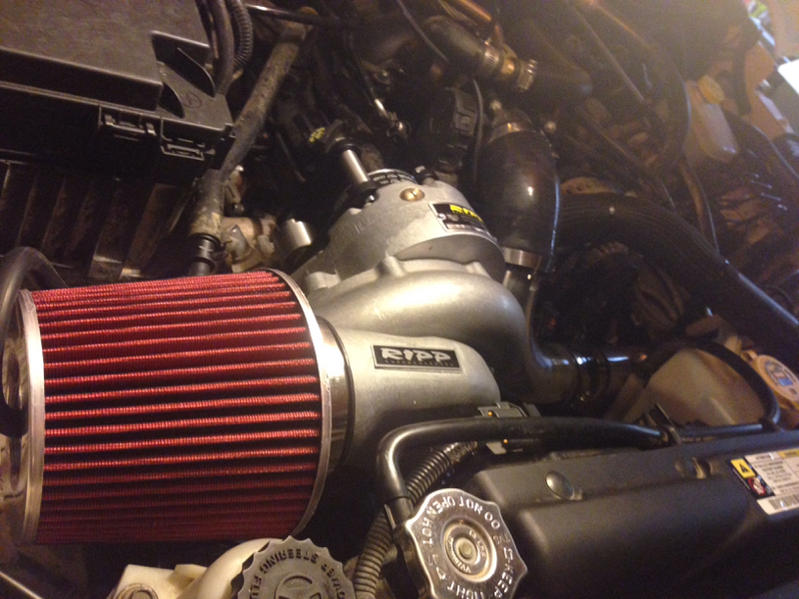

Hey guys, anyone know if you need to have the hose that connects to blowout valve and recirculates the air back to the supercharger? Without the house the supercharger woosh sound is so much louder and I kinda like that. Thanks for the help!

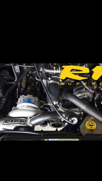

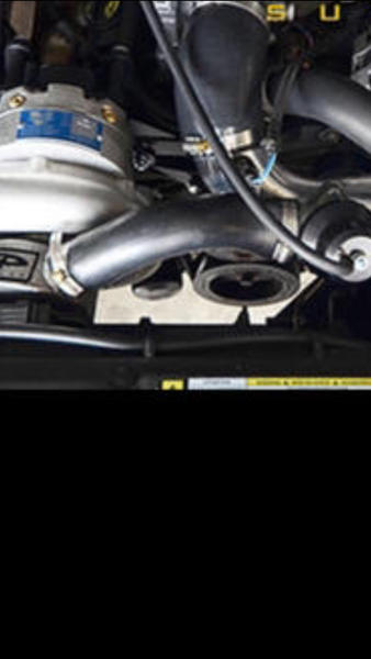

The bottom Hose from blow out valve back to supercharger

I just realized that I don't have that hose. Also my bov is on pipe 3..... Is yours a gen2 v3?
Yes it's a gen 2 v3 please send me a photo of yours did u install yourself? Thanks
I don't have the hose from the bov either that is a ripp stock pic

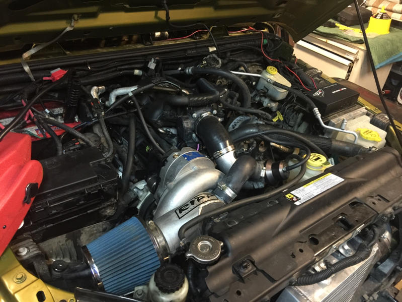

This is mine

Actually I do, but please attach a photo of your setup
Just in case someone else run into this problem.... I found the answer... The reason why I had that extra hose is because my supercharger kit had a silencer installed. The air is recirculated hence removing 90% of the woosh sound or whistle whatever from the supercharger. I guess all be removing that stupid hose and covering the hole that was drilled to recover the silencer hose thing. Now if I get tired of the whine all know how to cut it down.
ID:	595289 Click image for larger version
Best I have right now, at work at the moment..
