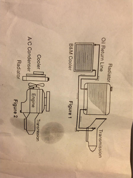

I installed the B&M trans cooler tonight. After I got done retread the original post in the write-up section. In that section and there are a lot of people who have followed that post,it say to run the top line to the transmitting. Yet the diagram from B&M says to run the top line to the radiator. Not sure what or if I did something wrong. If so do I need to change it right away?

I installed one of these. Think the difference is how you mount it. With both facing the top doesn't make a difference which one is in or out. If you mount it with them facing left or right it affects the flow. Hope this makes sense.

The lower fitting is in and the upper is out.

I installed it facing the right. Is there a problem if it is backwards?

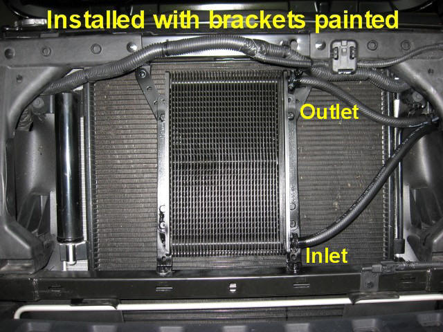

I installed mine awhile ago and it's been working fine I followed these instructions.

Probably gonna need to switch it. Imagine it has something to do with the way the system purges the air out. Just a guess. But like the other guy said I followed those instructions and it works great.
