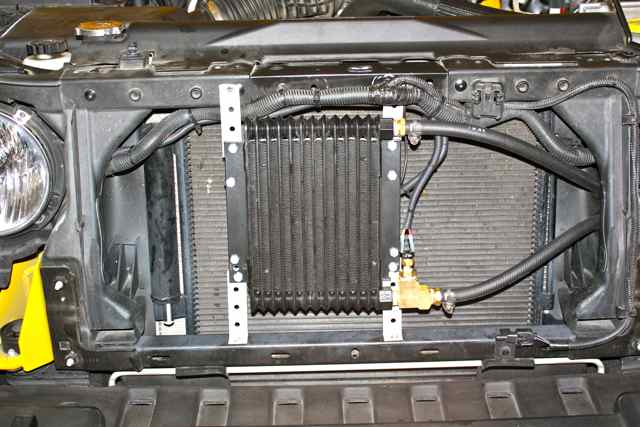

IMHO I don't think it makes too much of a difference with either location for installing. Don't recall hearing or seeing anyone on here with any overheating issues after putting this in. I just did this install and went right for the center.

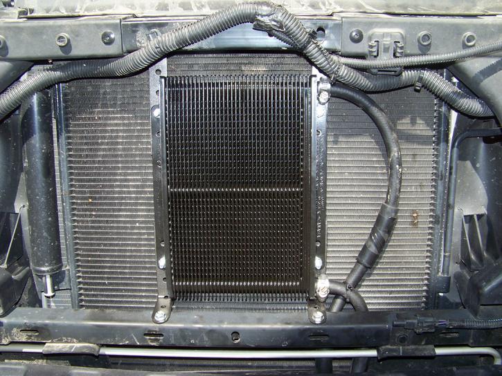

yeah, i did mine in the middle and works great! I dont think it matters either way though... I think it looks the best centered in the middle.

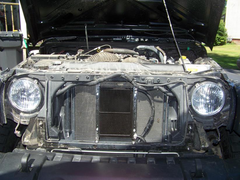

right in the middle, well i guess a little offset, no cooling problems. Mine even has it's own 7 inch fan behind it.

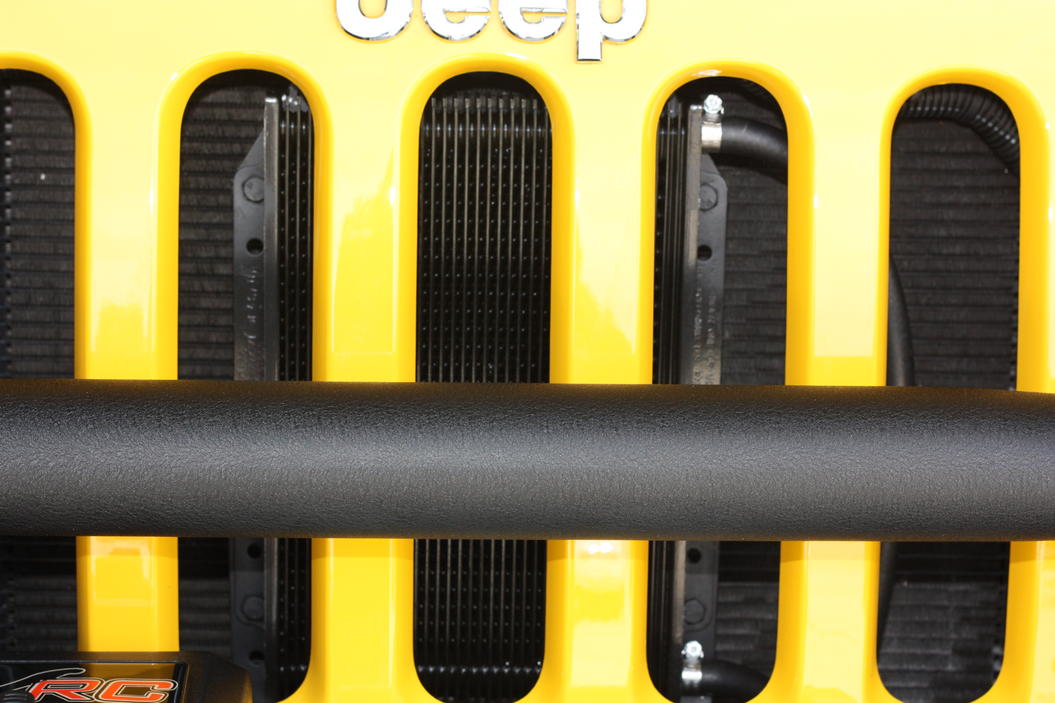

i put mine to the drivers side facing up and bought 4 feet extra 3/8 hose
I think it makes the install cleaner as you can't really see the hose runs
