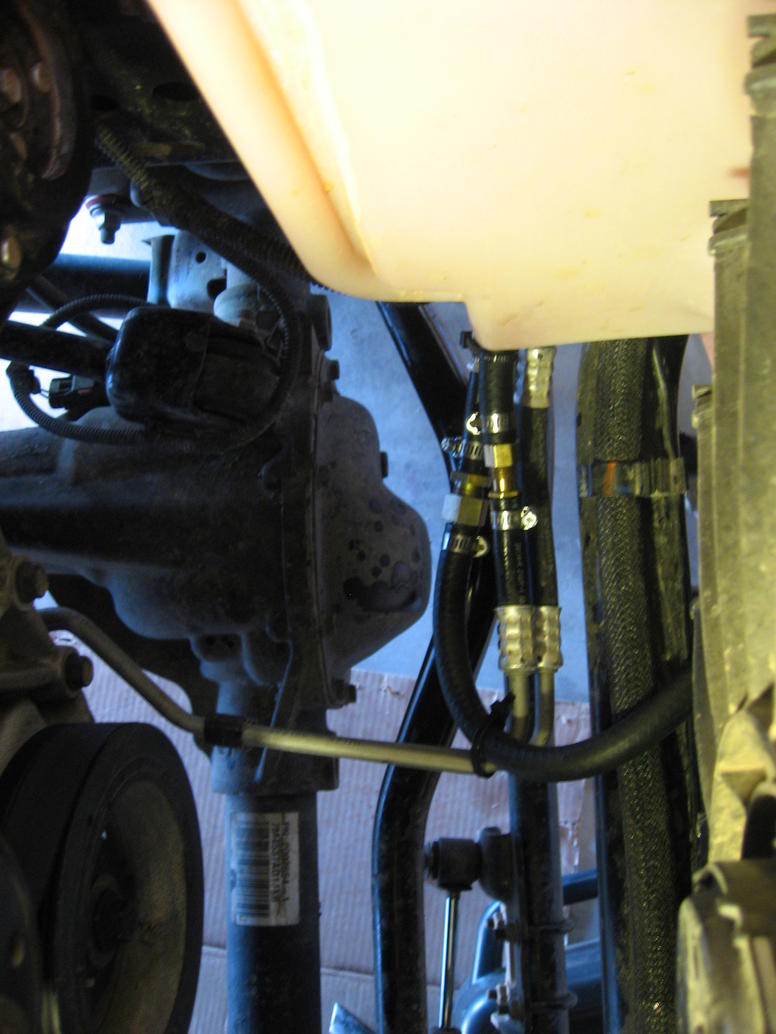

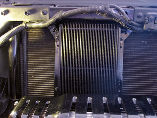

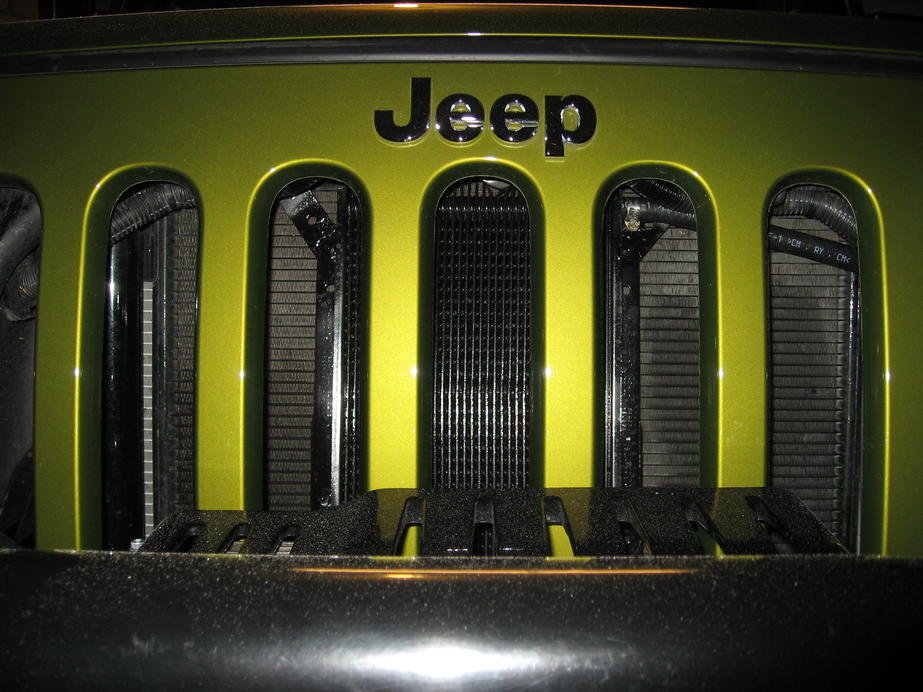

I used the included hoses. No problems (yet) in a little over a year. I have an Aeroforce gauge so I can keep an eye on things. It runs MUCH cooler now. I jacketed the rubber hose with hard plastic electrical loom to make sure nothing rubbed through.
Here's a couple of pics of my install (before I put the loom on):
Attachment 28992
Attachment 28993
Attachment 28994
Thanks AZJeeper,
I may just go with the included hose and see how it goes.
Thanks for the pics!
