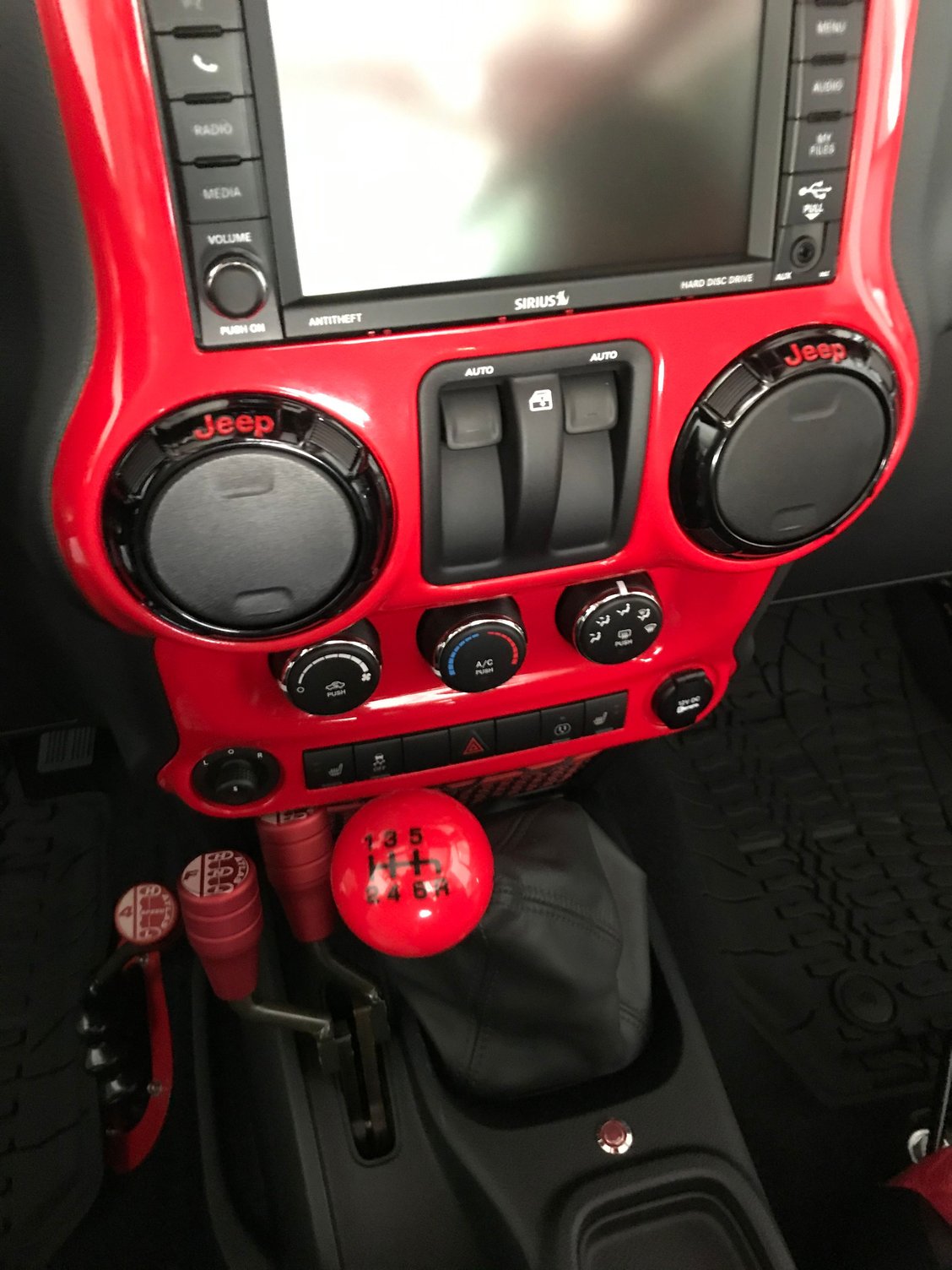

I installed the B&M Sport Shifter + the B&M short shift lever in my 2016 JK.
The throw is about a third of the factory movement, and is super positive shifting (it will never pop out of gear), but your days of quick shifts will be over.
When you first install it, the shifter will feel stiff and you will have to fight to find some of the gears, but once you are used to it - you would never go back.
Oh, and because their short shift lever is threaded on top - you can purchase an aftermarket shifter nob to further customize your ride.

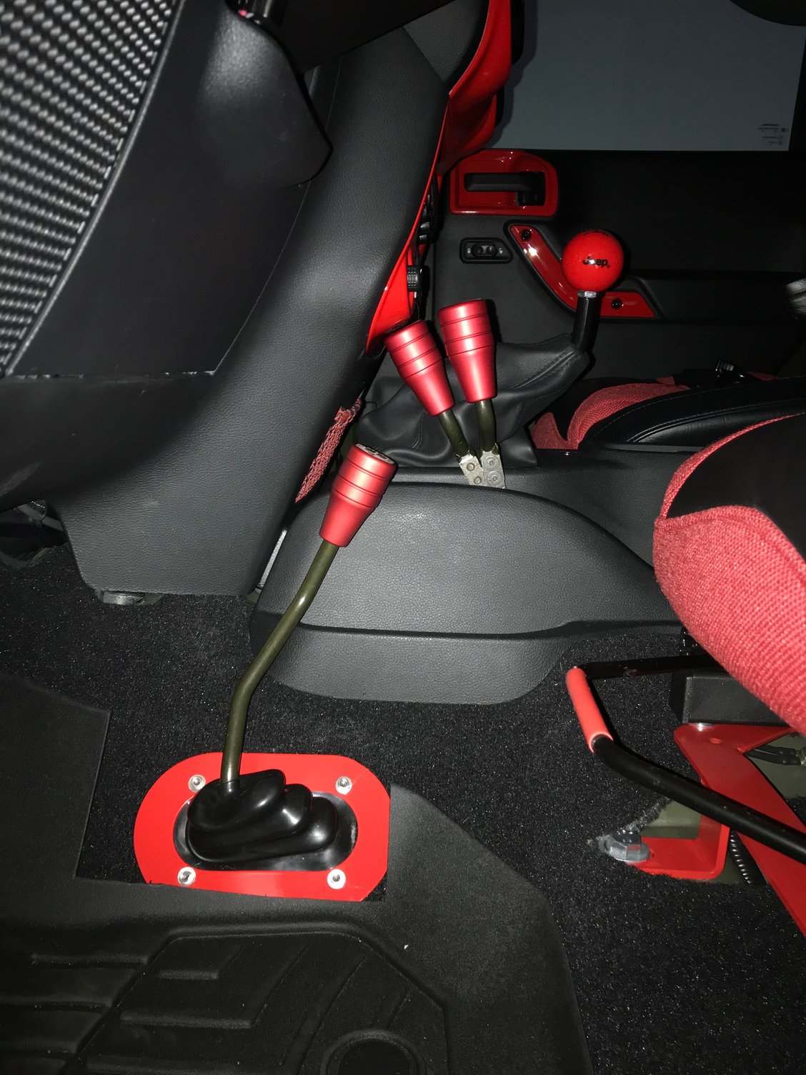

Is that a twin stick on your transfer case ?
Old Jan 4, 2024 | 07:22 PM
Creepy Neville's Avatar
5 Year Member
Joined: Jan 2018
Posts: 226
Likes: 80
From: Port Coquitlam, BC
Yep ….
I have an Atlas 4 Speed Transfer Case installed - the two levers are for the front and rear axles, the lever on the side is for the planetary gear.
The Atlas reductions are:
1:1 / 2.72:1 / 3.8:1 / 10.4:1
I’m running Dynatrac ProRock 60’s loaded with 5:38’s which ultimately gives me a final crawl ratio of about 360:1
