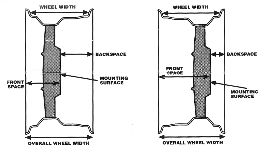

Take a straight edge across the back of the wheel from bead to bead and measure from the straight edge to the mounting surface of the wheel. Not exact but darn close.
