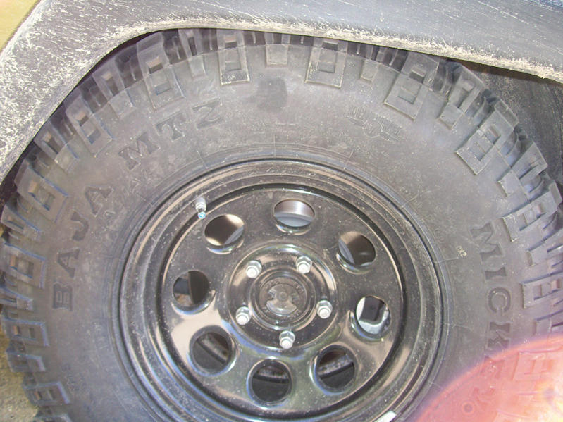

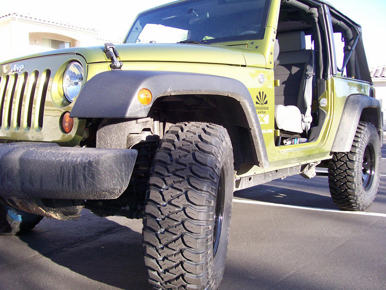

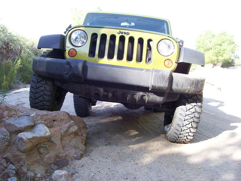

Myself and others are running cragar soft 8's with the 5" of backspacing, and they are doing just fine with no rubbing.
if you stick with a 285/75r16 you will not have any problems. if you go to a 305 you might.
so.. 33X11.5r16 will work just fine and you wont have ANY rubbing (at least due to backspacing issues) you may have some minor,very minor, rubbing at full suspension stuff.
33x12.5r16 may run into problems associated with backspacing on the 5". you would probabley have to run 4.5 or less not to have an issue ith the 12.5(i would still use the cragar soft 8's but I would run spidertrax spacers[or another high quality spacer that is 1.5" or less].
heres what my jeep looks like while running soft 8's with 5inch backspacing on 33's with no lift.
The last picture has nothing to do with backspacing(it has everything to do with no lift) It's at full suspension stuff and looks like it is rubbing.. its not (only has about 1/4 inch though!
