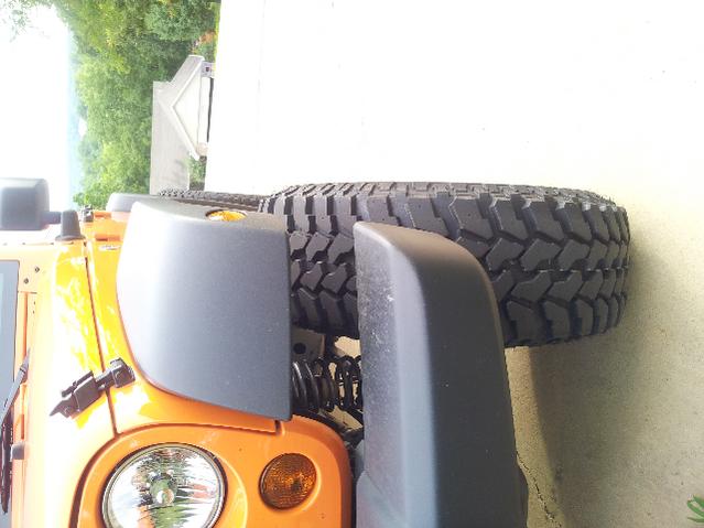

Here is my setup with 5.5 backspacing, 9" wheels and 12.5 wide tires.
I don't know why that's sideways...

Originally Posted by kcpanther
how far would that stick out from under the fender?
I believe your stock wheels have 6.25" backspacing, so if you went to a 4.5" bs wheel your tire/wheel will stick out 1.75" more than they do now.
