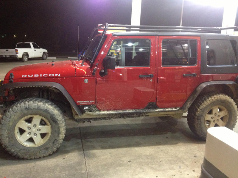

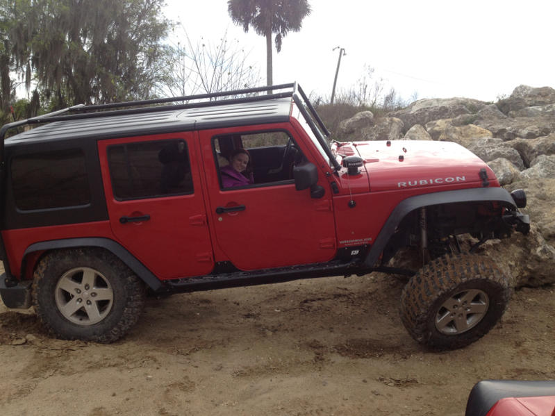

I wouldn't be wild about the idea. They mount very similar to my Pure Jeep rails. You need to be sure you LOVE them before you install them though because its hard to overcome all the holes you drill in the body.

I've beat on mine a few times and pivoted off of them and they've held up like champs. There's a lot more to the PJ ones than other body mounted rails. The PSC and Synergy look pretty stout as well.
