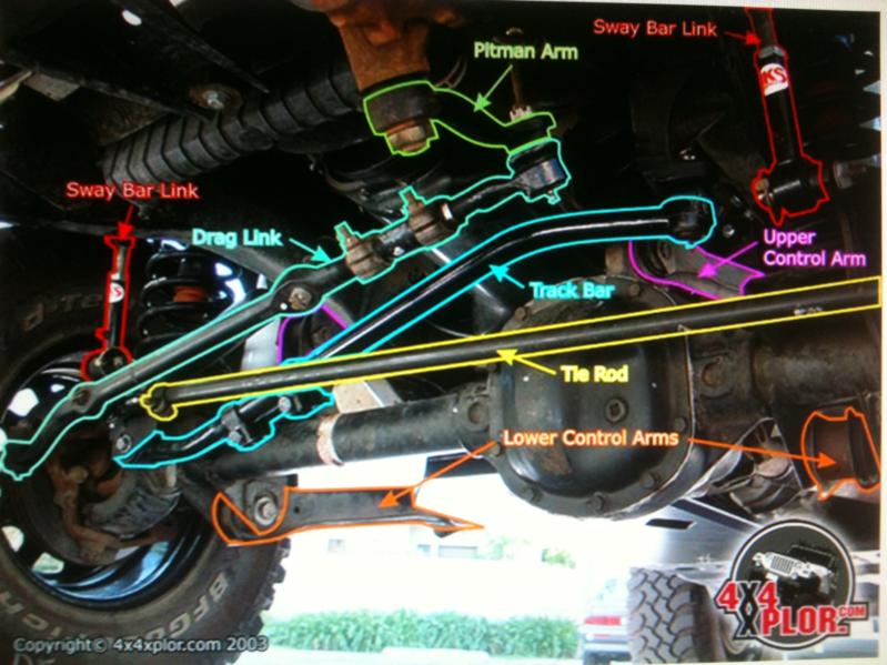

I keep this image saved in my phone to help me properly recognize all my front end parts. Save this image and do the same hope this helps
