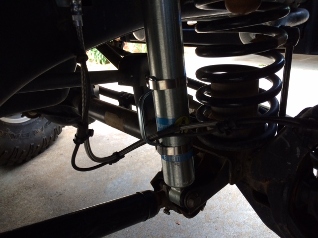

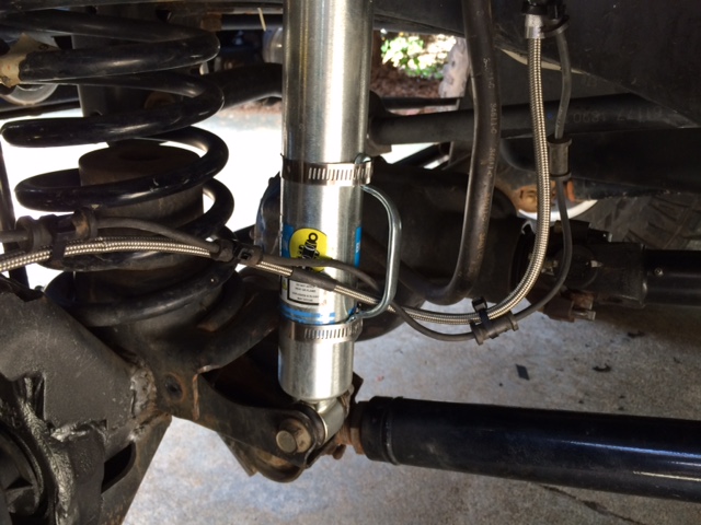

I was wanting to try and keep my extended brake line out of the coils so, this is what I came up with. See, how good it works if I go to Uwharrie this Saturday! I got all parts at lowes for under $10. 2 cheap cabimet handles and 4 hose clamps.

You should post this under the "low cost/free mods" thread. Nice idea! I have trouble keeping my lines out of my coils bc I'm 3-linked front and rear. I did something similar but yours looks great.

Cleaner option is to run them down the upper control arm and across the axle. No hanging lines anywhere.

Along control would be good. Might need a little longer lines. Will look into!

I used a carb spring. Works perfect.
