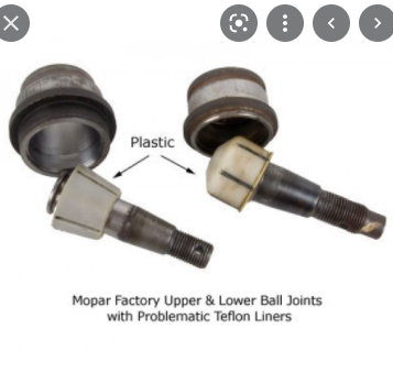

Here is the issue -
It's not so much that they "loosen up", it's that one of those caps cracks and at that point it's sayonara. Agree, you don't need knurled. Rare Parts is best you're going to do. Anything else is going to be a crap shoot. With 33s you might get by just fine, maybe not. All the mid-tier offerings are going to have mixed experiences from different members. If you can do the work yourself then maybe take your chances on a mid-tier brand. If you have to pay to have it done, I'd no doubt just put in RP's and not think about it again.
