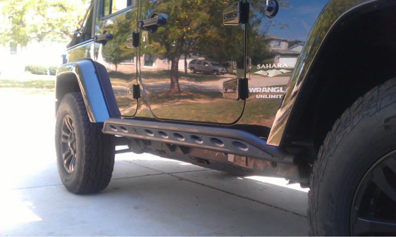

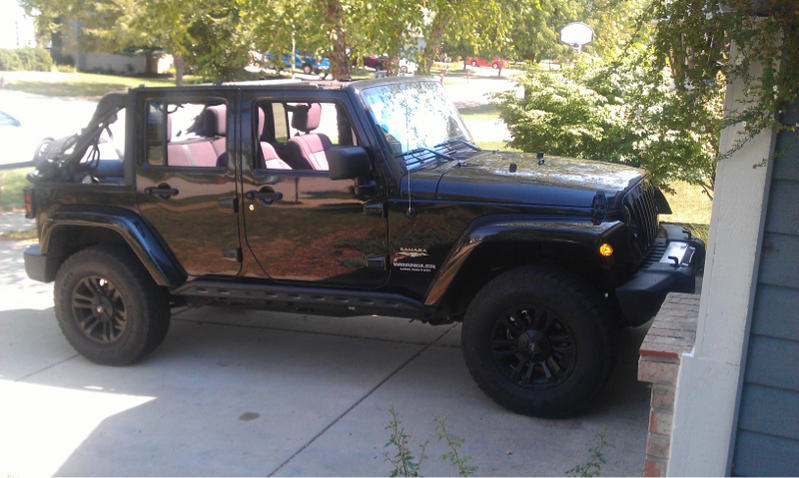

I rattle caned my Poison Spyder Rocker Knockers on Friday and went to the Badlands on Sunday. Paint held up great. I used black under coating on the rails and a grey metallic on the inserts. Very happy with the results. On the rails I filed down a few spots and whipped the rest down with vinegar to remove the oil. As soon as that dries, don't wait very long like over night because they will rust quickly once the oil is off them, I primed them with black primer. The inserts I sanded with 280 grit sand paper used for metal. Primed them with a grey primer. Two coats of primer on the rails took two cans. Two plus coats of under coating took four cans. Inserts, two coats of primer took more than a can and three coats of paint took two cans. I like the under coating because the rail are not slippery.

Couple of pics
