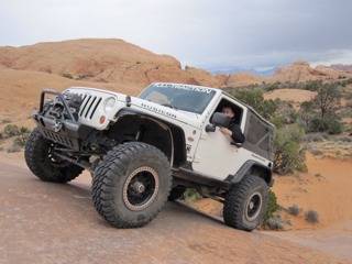

You can do a 3 inch coil lift with extended bumpstops and flat flares and you should be able to run 37s. You probably won't get a ton of articulation though.
Oh and cut, or bend your pinch seams.

I have the TF 2.5 coil lift, it easily fits 35s. I think w/ a 1" BL or coil spacers I could squeeze in small 37s. Oh, I'm w/ you on liking full fenders. Go to the show and tell section and look thru all the 37 tire posts and see what everyone else is running. If you like someone's set-up, PM them about specifics...

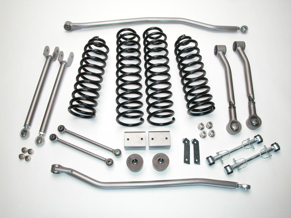

I ended up going with Trailmaster's 4.5" kit with driveshafts and shocks. It is a complete kit, has everything you need. Rides and handles great at a price that doesn't break the bank. Plus because of the longer control arms your rear tire is centered nicely in your rear wheel well and you won't have to do any trimming to run 37's.

x2....The Dirtman always has great advice. The Teraflex 2.5 coil lift will get 35's on there easily. So will the Rough Country, Full Traction and Rock Crawler. I run the Rust'ys lift.
When you want 37s, research before jumping. Flat flares and bump stops will get them on, but driveline and axle work will need done to do it right. The D30 will last depending on what type of wheel'n you'll do.

I went with 3.5" Clayton Off road kit and Woody Driveshafts. 35s fit easy, with flat fender flares and a little trimming 37s would fit. I think the 4.5" kit would be a better option for 37s. Then the questions is how to gear the axles for 35s or 37s. I would want different gears for 37s vs 35s.

I've ran 5.13's with 35's and now my 37's. I'm very happy with this set up. Our 3" premium plus kit is a great kit to start out with.
