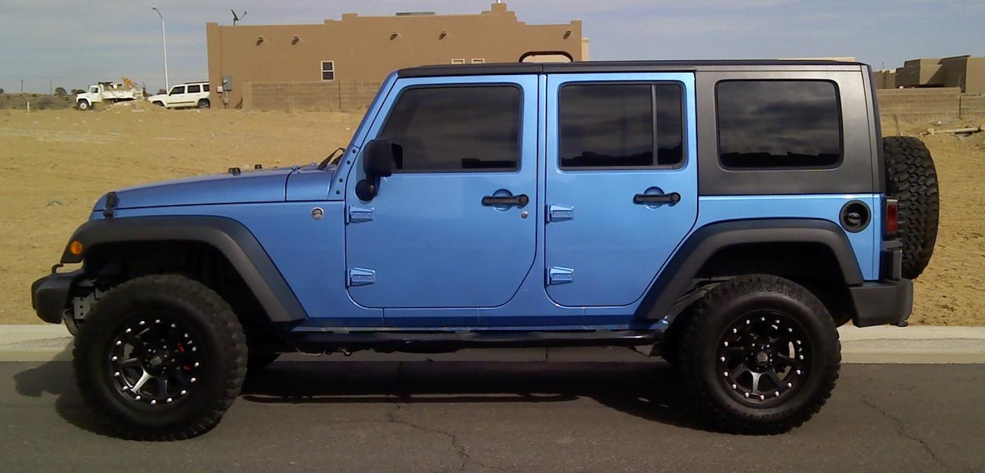

I did the Daystar 1.75" on mine. Love it! I seriously cannot tell a difference in the ride from stock. Super easy to install (I am sure they all are).
