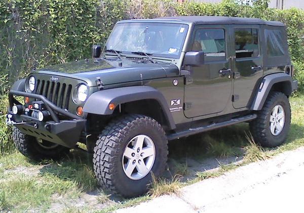

Here's JK Rocker's rig, 3in TF springs in frt, TFBB in rear

that jeep looks really good. i was just looking for a much cheaper alternative than buying new coils.
so i guess one cant just replace the factory isolator with a spacer? wouldnt it be the same thing but now the factory isolator is bigger

Yep, you could, then save for coils. Factory iso is really squishy anyway. Doesn't really matter , you could leave it in or out.
