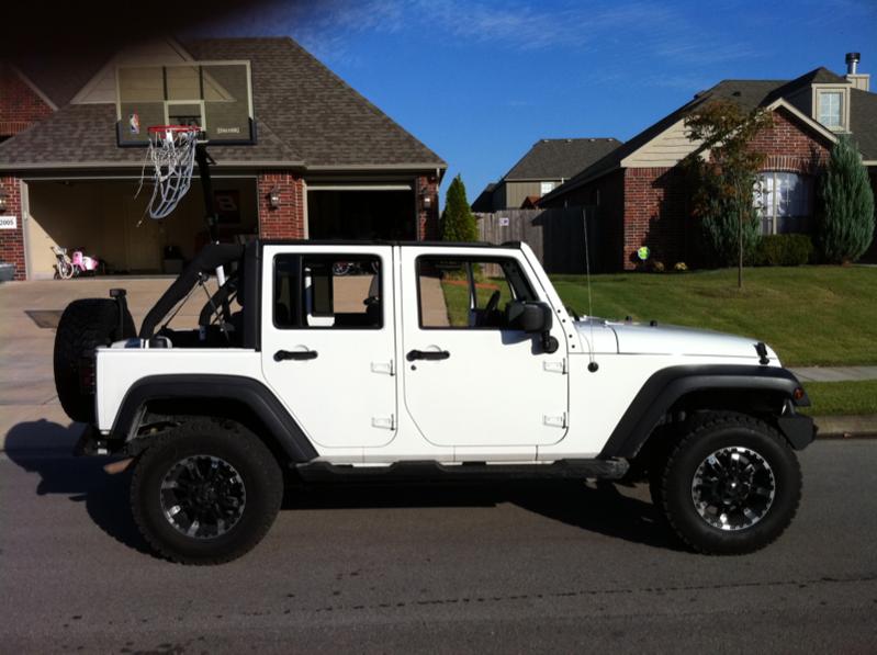

I have TF leveling kit..and I love it....I stayed away from the 2.5 cause i had to have it level...hated the rake...I currently run 33s...i will upgrade to 35s but when i do I'm gonna get a 1.25 body lift...I got 1.5" of lift...

Coondog, your jeep looks great. Nice work.
j33p_freak, Something else worth mentioning at this point, if you want 33s, and do the Leveling kit, if you add a heavy bumper/winch it will negate the 1.5" of lift you get and will re-introduce the rake if you do not get the coil version. If you are not planning on adding bumpers, etc, then you can see by Coondog's jeep that it will look great with some 33s.

Thanks Hawnted...Hawnted brings up a great point on winch and bumper sag...if you get a coil lift you can add spacers to eliminate the sag...I have RR stubby..with hoop...not heavy at all...no sag...my rear bumper is a tube rock crawler and is very light...just something to think about if ur gonna get a winch and heavy tire carrier..
