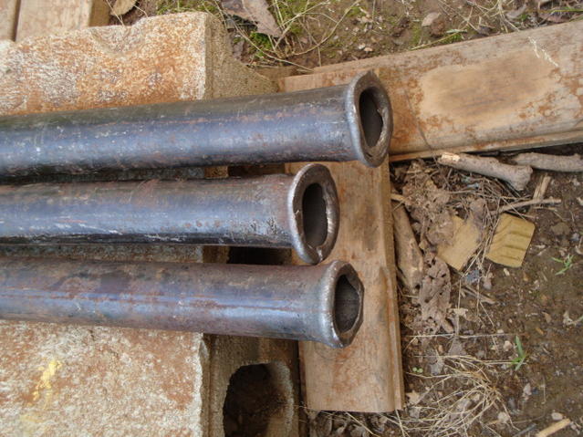

I put mine in the freezer overnight and used some bearing grease on the outside to help them slide easier.I used a 10 lb hammer and some pipe with the bearing tool sitting inside of it.

I did mine solo! I put on a 5 gal bucket and bracing to hold in place, then move the axle up/down with the jack under the axle to get proper hight. I would also weld on a metal block to end of the pipe to keep from crushing in, as pictured. I wrapped duct tape around handle to hold in pipe, and would get a 20 lb. sledge!!!!!!!
I would hit once, then have to reset, hit, reset, etc. It took 8 hrs. to do! Also, keep the opposite tire mounted and on the ground to help keep the axle from moving every time you hit it.
