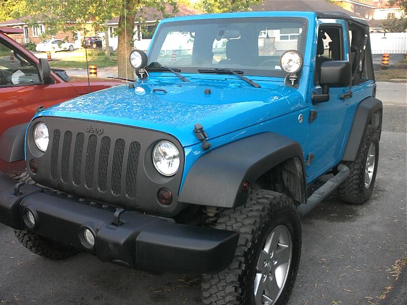

I bedlined mine last winter. Seems to be holding up well. Lightly sanded the grill and hinges. Put on a coat of primer. 3 coats of duplicolour bspray bedliner, the aerosol cans you can buy at the store. Also did my step bars. Seems to be holding up very well. After a year, (and once you clean it) everything is still nice and black. And the colour and texture matches the look and feel of stock black plastics on the jeep. Plasti-dip is something some of my truck buddies have used, and its fine, really easy to do, easy clean up. But its not anywhere close to being as durable. The main thing is that it takes no time to re-do your plasti-dip job. So you can put on a fresh coat every year to keep the colour bright. Personally i like the bedliner better though[attach=config]445932[/attach][attach=config]445933[/attach][attach=config]445934[/attach][attach=config]445935[/attach]
