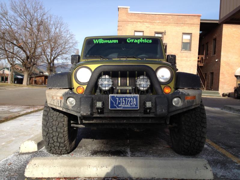

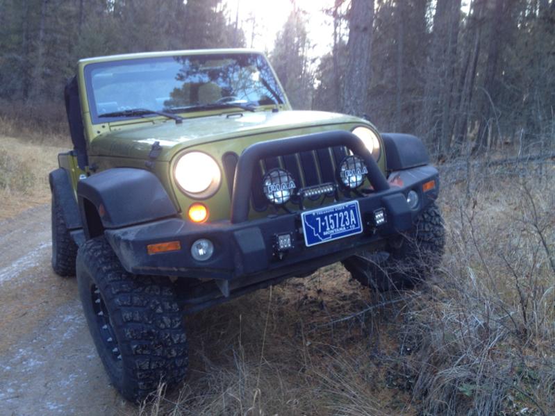

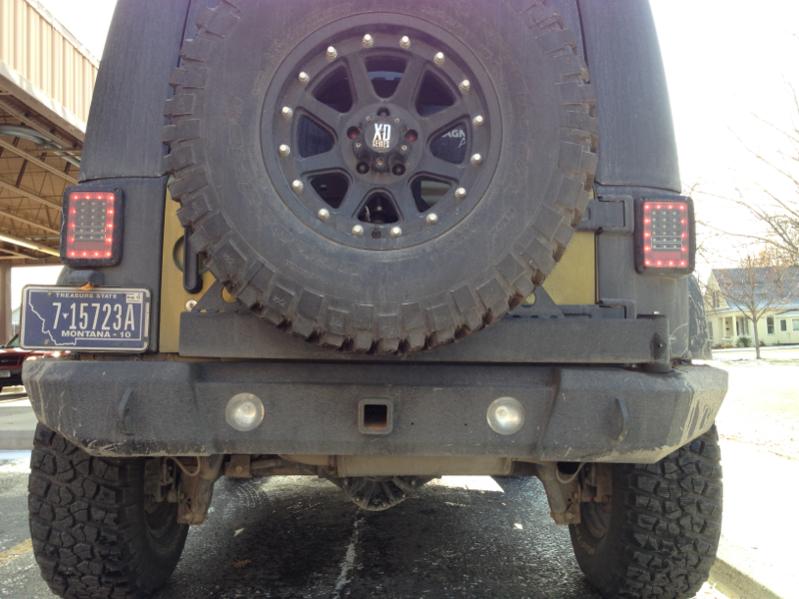

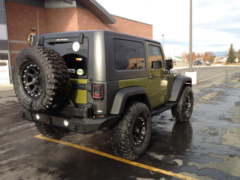

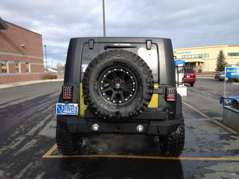

I had all my bumpers and flares and steps Speedlinered. Professionally done spray on bed liner. It's 2x the strength of line x and half the cost. Guaranteed to never fade. Full lifetime warranty. If it fails for some reason they will strip it and respray it for free. Great stuff!
I know they are poser pics. But it gets the point across for seeing what the material looks like.
