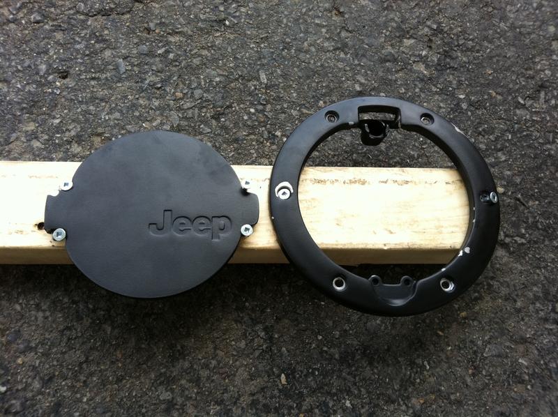

Before
it was chromed which I scuffed up and painted but that flaked off in no time.

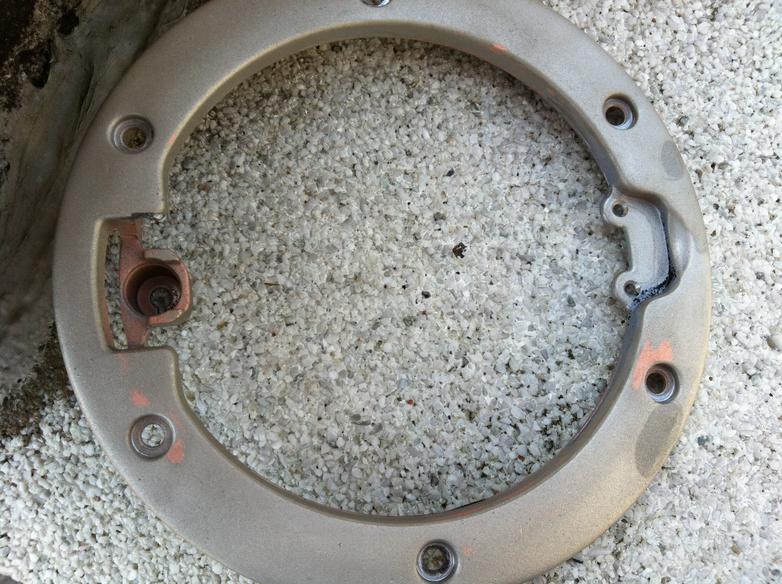

After a wet sand blast followed by three coats of self etching primer
ID:	154082Click image for larger version

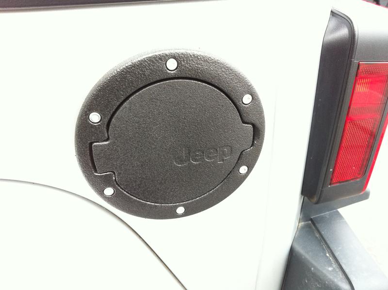

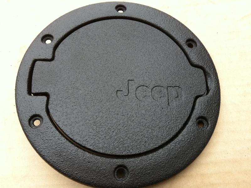

Final product with three coats of bedliner
ID:	154085Click image for larger version
