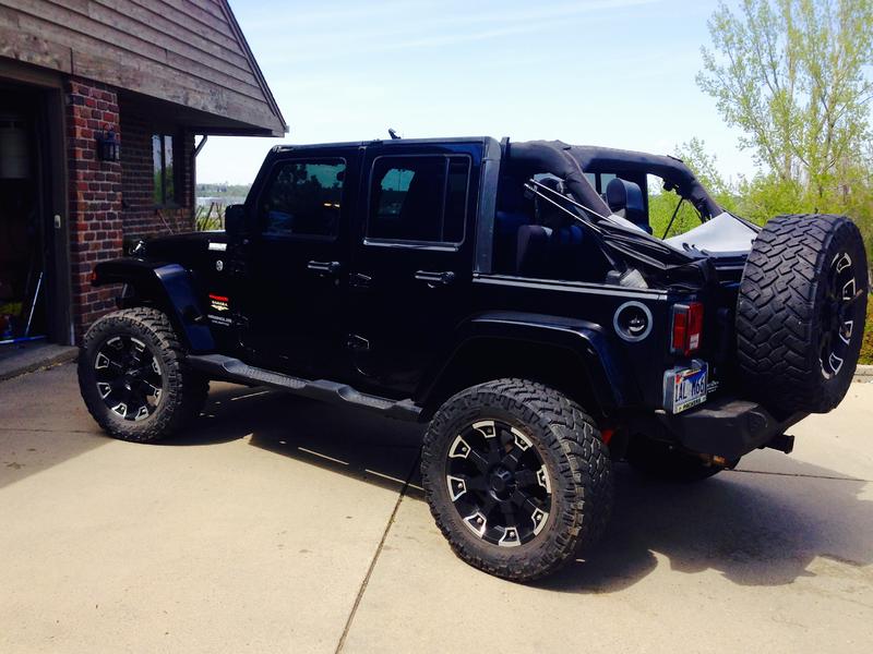

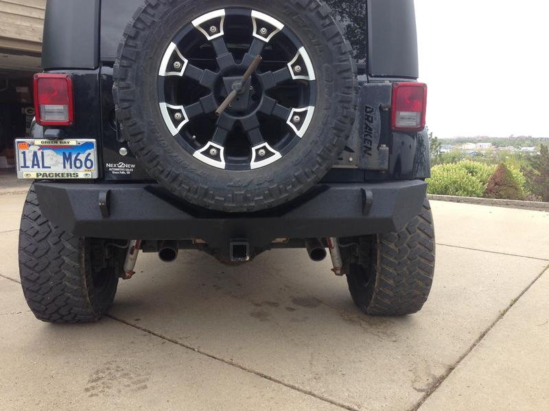

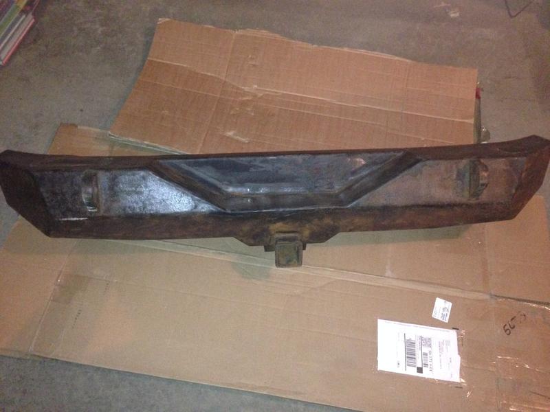

I did this on my Jk last summer. Ground down all of the rust with a grinder and steel brush attachment, painted two coats of por 15 followed by a final coat of por 15 with a primer sprayed on halfway through drying. Then waited for that to dry completely and did a last coat of primer, followed by duplicolor truck bed liner. All of the salt and grime on the South Dakota roads has not effected it one bit and it looks just as it did the day I got done painting it. Now to do the front bumper! Hope this helps.
