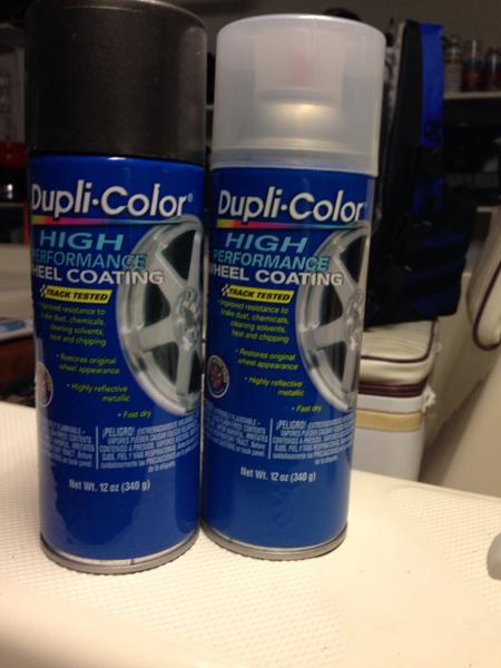

I like the look of bedliner as well and will be doing my wheels quite soon. I did the wheels on my '07 bmw and loved the paint and the way it came out. Very durable as far as pressure washing (2300 psi), no problems. I did three coats of color and two coats of clear. Hope this helps.

Thanks for the input. I looked at Duplicolor but they didn't have a matte black finish sadly.

that sucks! I really like the way it lays and had very good coverage.

Wops, yes I put primer down on it as well. I masked off the tire by using index cards.
EDIT: Just saw the picture that LordV8R posted. That was the stuff I used. Painted it on a Saturday, let it dry into Sunday and mounted it back up. The TJ's had steel wheels which is the cause of a bit of rust over the couple years. We have heavy salted and graveled roads up here for winter and worked great.
