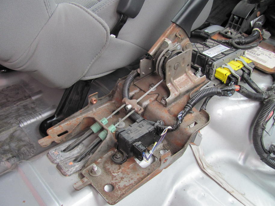

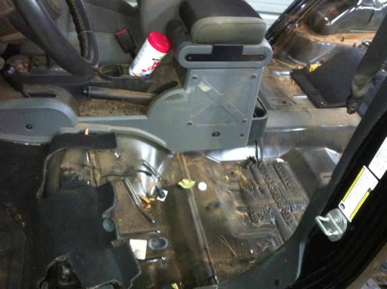

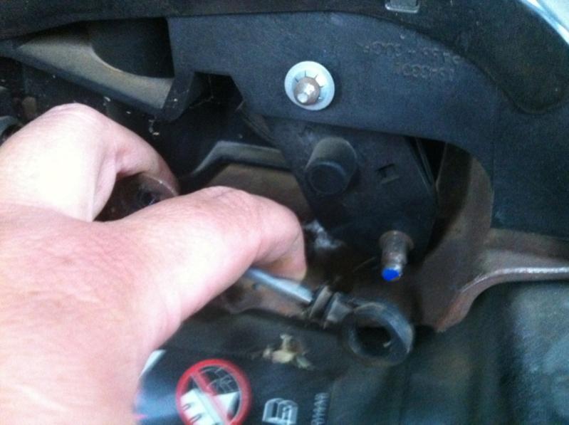

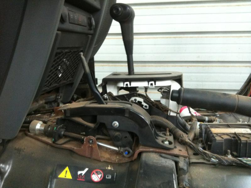

Well my friend and i have been gutting my jeep rubi for interior bedlining. What a chore! The crap on the floor is taking longer than all the other stuff we had to unbolt to remove. While i was at it also discovered not only is my bottom transfer case cable end bushing died but the end at the shifter did too! I am going to revamp this into something more robust because this is not easy to get to at all.

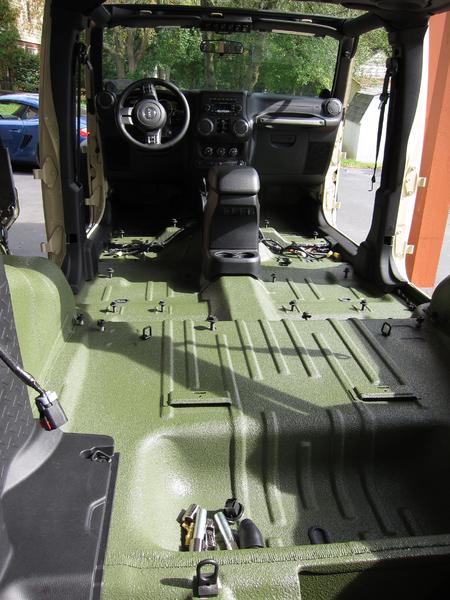

Flashback
ID:	229398Click image for larger version
ID:	229399Click image for larger version
ID:	229401Click image for larger version
take your time and make sure you pay special attention to hitting every painted surface with a wire cup brush or similar

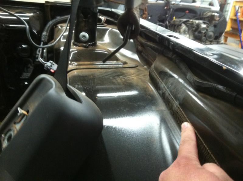

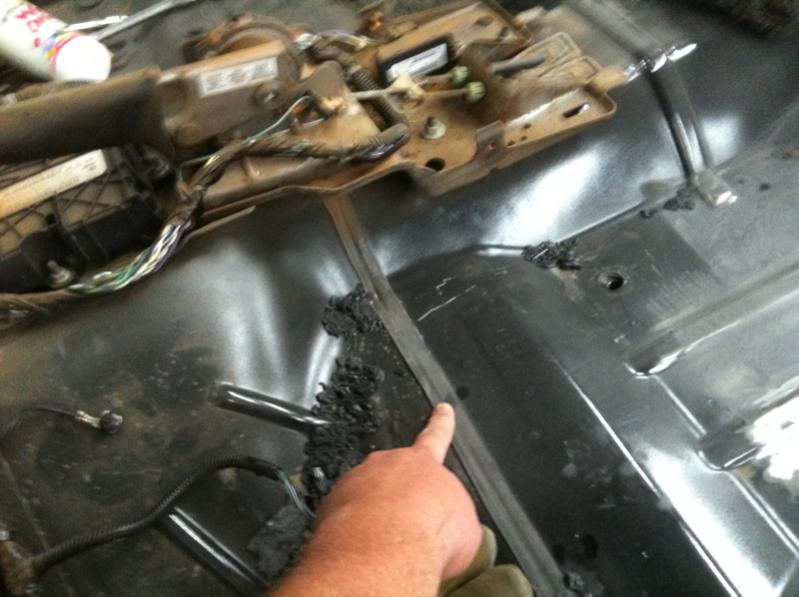

Did u remove all the sealant from the wheel well corners and accross the middle of the tub?
ID:	229434   Click image for larger version
Old Oct 28, 2011 | 06:28 AM
jeeperjkjeeper's Avatar
Posts: 1,891
Likes: 5
From: Great Lakes
No ....i left the seam sealer in place....just took off the sound/heat insulation from the footwells.
Old Oct 28, 2011 | 06:48 AM
WCDAVE's Avatar
Posts: 408
From: West Chester, PA
X2 I debated removing the seam tape, but the bedliner covers it well and it is not as unsightly as the footwell insulation which resembles vomit.
