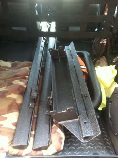

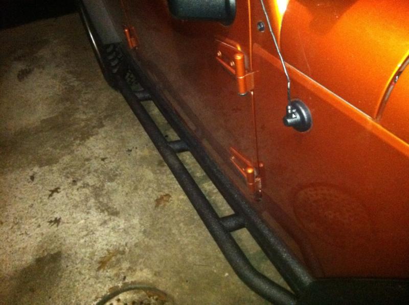

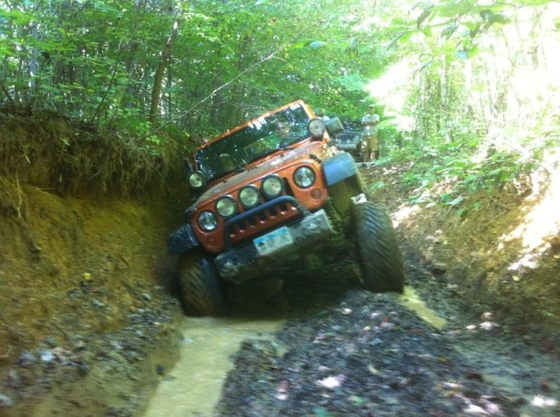

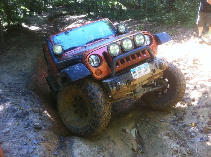

A few pics clean and new. A few pics of wheeling. If it gets really muddy I take simple green and a stiff bristled brush to the line-x and it looks like new. Everything you see in the pictures that is black and metal is line-Xed. It is worth the drive. as stated above lifetime warranty.
They only scuffed the powder coat. I think your getting hijacked about having to be bare metal.
