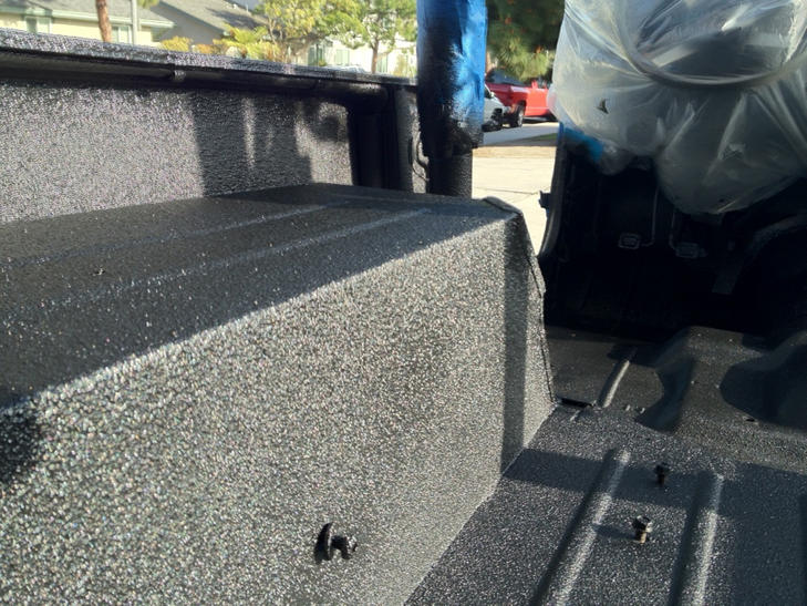

I pulled my carpet out of the jeep and hinted to the wife that it sure would be nice line-x'd and she total went for it. So I went to the line-x place here in town and they said it would be $450 if i stripped it or $650 if they had to strip it all down. I already have my carpet pulled and the backseat stays in my spare bedroom. The only thing that kinda has me worried is they said they had to pull the roll bar. I have read a bunch of threads and watched a few YouTube videos and I never heard them mention they had to remove the roll bar. What are yalls thoughts?

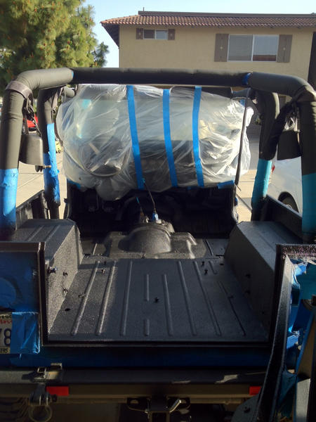

I bedlined the interior of my jeep myself and cant see what reason they'd need to remove the roll bar. I would imagine if their worried about getting overspray on it that they could just mask/tape it off. I'd give them a call to see what reason they require the roll bar to be removed

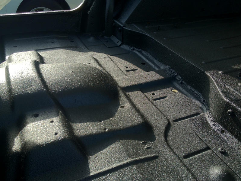

You can buy a Raptor lining kit that comes with everything and do it yourself. The kit is $120 and then all you need is a compressor. I'm sure there's a thread on here about it Raptor kit. I've had a couple buddies do it and it looks great. Plus it comes in different colors.... And he never pulled the roll bar

Kinda strange that they consider it easier to cut it off and weld it back on than to mask it off. Call them and explain its welded to the tub and not coming off.
As for stripping, pull the passenger seat, plastic floor trim, seatbelts, plastic tailgate trim, floor plugs and the center console. Also get a trim tool and pop off the clips that hold the wiring harness to the tub and bungee it to the roll cage so they dont cake it with Line-x
