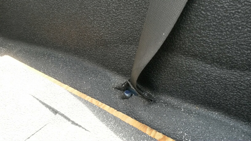

To the ones who had installed this, what did you do with the rear seat belts? Do I need to cut holes to fit the seat belts? Or should I just remove the seat belts altogether?

I unbolted them to fit the piece in then cut a hole for it to fit. I'll see if i can get a picture in the morning.

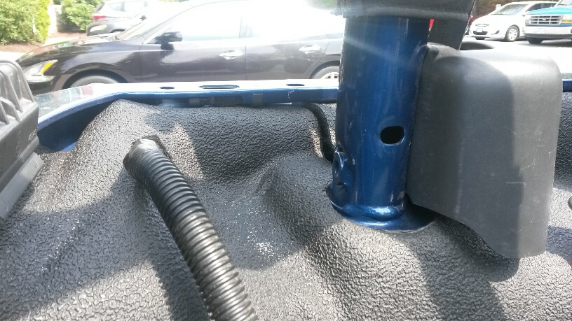

Pics would be great! Thanks! I appreciate it. I test fitted the wheel wells today and they didn't seem to fit too well on top at the rear roll bars and at the bottom where they are tucked in on the side/floor. Would you post pics on how yours look?
ID:	623298Click image for larger version
Once the piece in in place and you fiddle with it they do fit pretty well. They just need to be shoved under a lot of the interior trim pieces to make them fit properly. I left mine in the sun for a few hours just to make them more pliable with definitely helps. I did have to cut a hole for my hardtop wiring harness.
